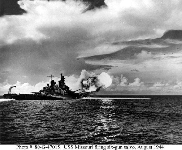

USS Missouri BB-63
Note the projectiles in flight on the right.

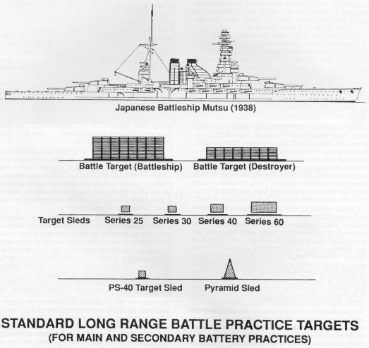

The target for most gunnery exercises was a sled towed by another battleship, a tug, or a destroyer.  As the figure below shows, a wide variety of targets was employed, the largest being towed on 172-foot long battle rafts.  For long range practices, potential targets larger than a light cruiser were represented by a 140 foot by 40 foot "battle rafts" made up of light wood battens (which allowed "overs" to be spotted through the mesh).  Destroyers were represented by a 140 x 20 foot screen.  For short range practices, a wide variety of "sled" or "high speed" targets were used.  The largest of these, the PSAO, displaced 28 tons, and carried three 25-foot square target screens.  The target screen for 5-inch short range practices was typically 15 feet square with a 6 foot bulls-eye at the center; from 3,000 yards, almost every shot was expected to hit the screen.  Pyramid targets were used only as drifters.
Rarely, live firings were conducted against actual ships.  These were hulks if they were to be sunk, grounded wrecks or radio-controlled "mobile targets" if they were not.  Destroyers Lamberton and Boggs, and ex-battleship Utah (normally used as a live bombing target) were available in 1940.  Firing directly at the mobile targets was generally forbidden - a single heavy caliber hit could easily do extensive and perhaps irreparable damage - and the mobile targets were in practice most often employed as towing ships, especially where the use of a very short towline could permit the simulation of difficult and otherwise potentially dangerous maneuvers.  When a towed target was unavailable or inconvenient, offset practices could be fired instead.
Regardless of the actual size of the target itself, which often served only as an aiming point, standard scores were often computed - and merits assigned - with reference to a so-called "constructive target," a mathematical entity designed to represent the vulnerable area of a typical target vessel.  The constructive target, laid out as an imaginary rectangle on the surface of the ocean, was 564 feet long for battleship or aircraft carrier targets and 258 feet long for destroyers.  The width or "beam" of the constructive target rectangle varied with the angle of fall, and was thus dependent upon range and the type of gun firing the exercise.8  Although surface gunnery targets experienced relatively slow evolution, aerial targets varied markedly over time.  In 1940, five types were available, the smallest 31 inches in diameter and 19 feet long, the largest 42 inches in diameter and 30 feet long.

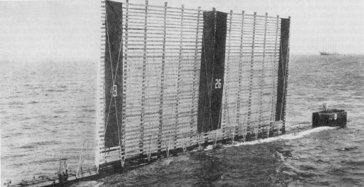

A 20 foot by 60 foot raft on the way to an exercise.  They were generally in much poorer condition coming back.  Although this photo was probably taken during WWI, this same type of target was employed through to the end of WWII.
W. Jurens collection.

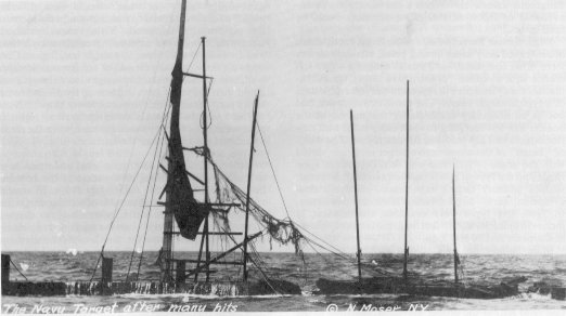

After the storm.  Targets often returned from battle practice much the worse for wear.  Compare with previous photo.
C.C. Wright collection.

(h) The target shall be one battle raft.18

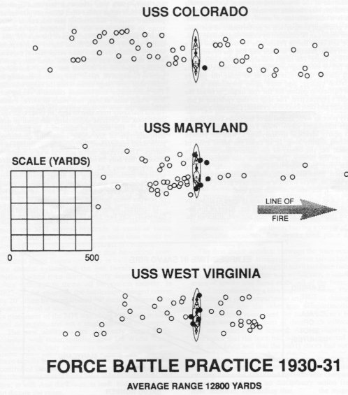

Force Battle Practice (a variation of Long Range Battle Practice) for the 1930-31 gunnery year was specifically designed to test the battle line in engaging a numerically inferior force at close range, to test the efficiency of dye-loaded projectiles in concentration fire, to study the effect of torpedo fire on an engaged battle line, and to exercise casualty procedures in battle.  Although this was a short range reduced charge practice for most ships in the fleet, the mean gun range being 12,833 yards, New York fired full charges at 12,700 yards, so this was a high-velocity practice for her.  The plan was to have the eight ships in the line fire in double concentration on four battle targets during the beginning of the practice, shifting targets part way through the shoot to put two targets in triple concentration, and leaving the other two under fire from single ships.  The changeover did not go well; although New York correctly switched targets at the appropriate time, both California and Idaho bungled the swap, so that instead of ending up firing at her own target, New York found herself sharing a single hapless target with two of her offending sisters in triple concentration.20  The officer in charge of simulating casualties cut off New York's plane spots alter the second salvo, and disconnected the main-battery telephone circuits alter the fifth.  Mechanically, the main battery worked flawlessly, with the gunnery officer noting "All ammunition (70 rounds) was expended and there were no casualties except those constructively imposed."
The firing started out poorly, improved during the middle part of the shoot, and deteriorated during salvos six and seven.  Lt. Murphy, the gunnery officer, noted laconically ". . .The first salvo had an excellent range pattern of 250 yards [and] a good deflection pattern in the neighborhood of 100 yards.  Two plane spotters stated that all the shots in this salvo landed so close together that it was difficult to distinguish the individual splashes.  Unfortunately, the mean point of impact was 1,252 yards over . . ."  There were two wild shots in deflection on the sixth salvo, and two more in both range and deflection on the seventh.  These doubtlessly originated from Turret III, which "...  upon the casualty to the fire-control telephones went to pointer fire for some unaccountable reason." New York's time for the practice, 6 minutes and 43 seconds, was considered undesirably slow, the lag being accounted for by the need to hold up the second and third salvos to receive plane spots (which were being shared by USS Texas), by the requirement to shift fire alter salvo four, by the difficulties imposed by the loss of telephone circuits alter salvo five, and by the use of an inexperienced director pointer.  The average loading interval was 31 seconds; the director interval 10; the salvo interval, 66.  New York's merit for the practice was 21.255, ranking her fourth out of eight, achieving 0.1931 hits per gun per minute.  The best ship, Texas, achieved 0.4067 hits per gun per minute, and the worst, Tennessee, got only 0.1337.21
As before, the normal battle target has been replaced by the outline of a 785 foot, 20 knot target.  The signal to shift targets came at 1 minute 55 seconds into the firing, but fire was not shifted until after the fourth salvo.  Clearly, the change imposed little difficulty, as hits were obtained on the first salvo fired on target number 3.  The loss of communications imposed alter salvo five obviously had a much greater effect, opening the pattern significantly, although hits were still obtained.  The recovery from the large error associated with salvo 1 is remarkable, and in fact New York would probably have actually hit on salvo 2, fired 1 minute and 50 seconds into the practice.  After that, she would have obtained two hits on each of salvos 3, 4, and 5, and one hit on salvo 6, this within 7 minutes and 13 seconds.
Vice Admiral Leigh characterized New York's performance as ". . . generally good, though the lack of fire discipline in the case of turret II probably lost the vessel some hits.  The imposed casualties were handled correctly and promptly, though difficulty was experienced with voice-tube communication alter the fire control telephone system was placed out of commission." Leigh characterized the performance of the battle line during the main battery portion of the practice as "disappointing." "The volume of fire was comparatively low," he wrote, "the patterns (especially in deflection) were generally larger than was expected, the number of shots in the control zone were low (being only approximately 20 per cent of the shots fired as against the standard of 50 per cent set by reference (d)), and the fire discipline in some cases was poor."22
