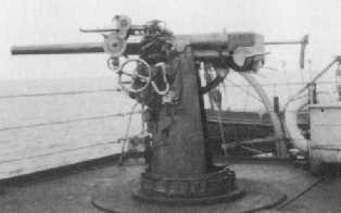

A more powerful gun than the Hotchkiss 3-pdr, this weapon was used as a secondary gun on cruisers and later as an AA weapon during World War I.
Actual bore length was 50.05 calibers.
3-pdr on HA mounting
Monitor HMS Sir John Moore about 1918
