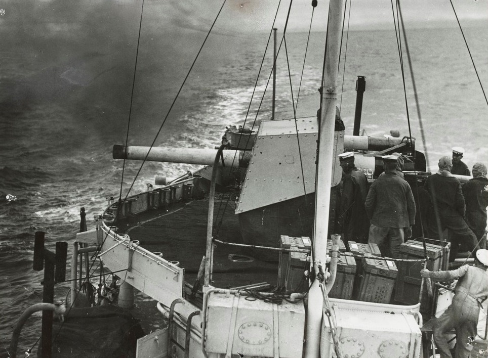

HMAS Vampire ca. 1938
4"/45 (10.2 cm) Mark V in LA CP Mark II mounting
The muzzle of "D" gun can just be seen below the muzzle of "C" gun
Argus newspaper collection of war photographs
State Library of Victoria Image H98.105/3252
