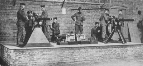

6-pdr Hotchkiss QF
Photograph copyrighted by John A. Roberts
