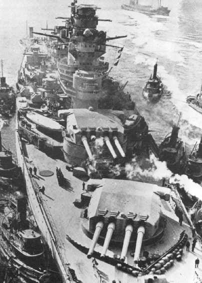

Battleship Richelieu in the 1950s
Photograph courtesy of Charles Cordier

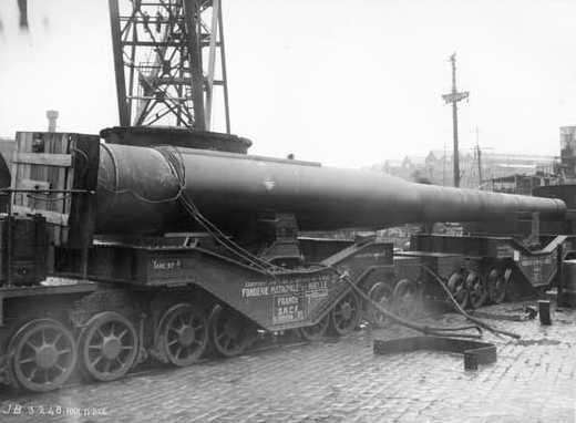

380 mm gun for Jean Bart in February 1948

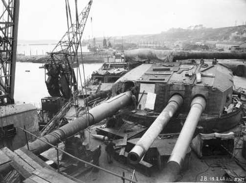

The gun pictured above being installed in Turret I on Jean Bart in February 1948
Note the gun awaiting installation behind the turret
