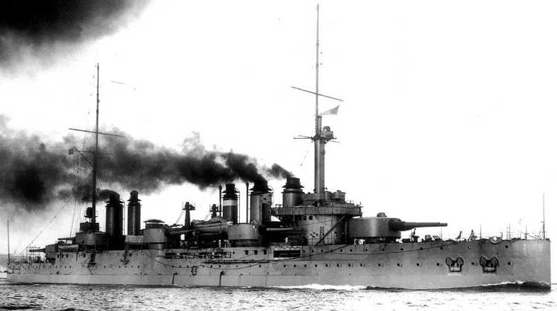

Battleship Danton
The 75 mm (2.95") guns are in the hull casemates
