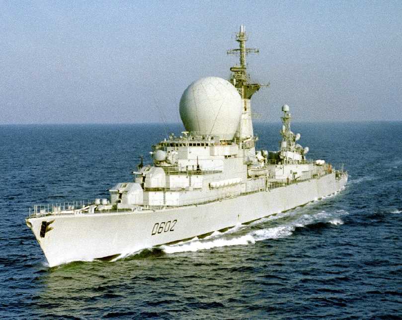

French destroyer Suffren in May 1983
U.S. Navy Photograph No. DN-SC-92-01092
