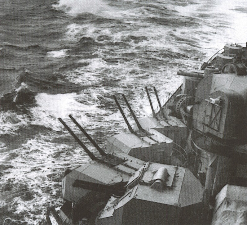

Guépratte 20 October 1961
The 57 mm mounts are in "B", "P" and "Q" positions while 127 mm/54 twin mounts are in "A", "X" and "Y" positions
Photograph copyrighted by L & L van Ginderen

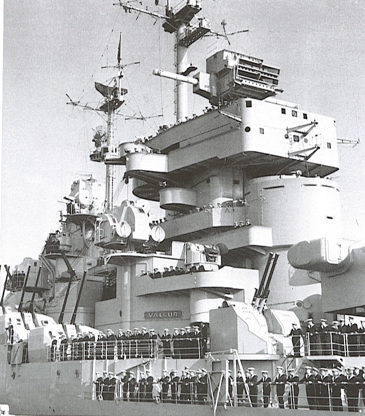

57 mm/60 twin mount on Jean Bart in 1953
At left are 100 mm/55 Model 1945 AA guns
ECPA(D), Ft. d'Ivry Photograph

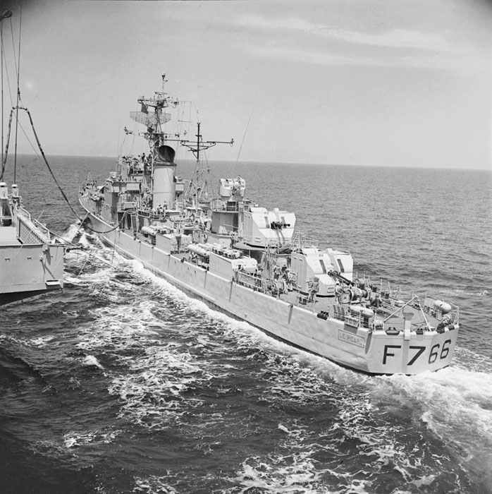

Stern 57mm/60 mountings on Fast Escort (L'escorteur rapide) Le Picard in April 1962
Établissement de Communication et de Production Audiovisuelle de la Défense (ECPA D) Photograph No. D46-01-04
