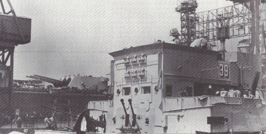

Postwar photograph of Z39 showing two twin 3.7 cm Mark 42 guns in front of  the bridge and twin 20 mm in the bridge wing
Note the USA Baltimore-class 8" (20.3 cm) turret in the background
USN HIstorical Center Photograph

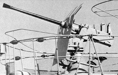

3.7 cm/69 M42 on U-995
Note the feed guides, which were similar to those used for the 4 cm Bofors
Photograph courtesy of Dave Krakow
