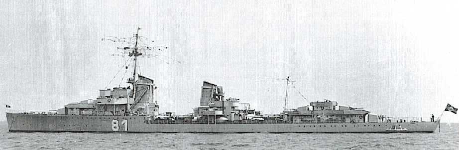

Hans Lody Z10
Hans Lody was one of the few destroyers to survive the war

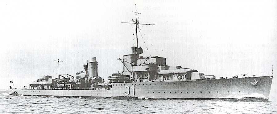

Destroyer Friedrich Ihn Z14

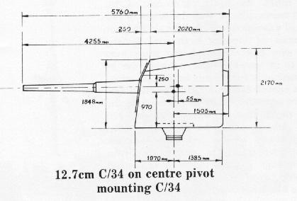

Diagram from "German Destroyers of World War Two" by M.J. Whitley

Designation Single Mount
   Germany:  Destroyer Types 1934 (5), 1936 (5), 1936B (5) and 1938B (4), T61 (4), Bremse (4) and Grille (3):  MPLC/34
   Leopard (3) and Luchs (3):  MPLC/28
   Greece:  Vasilevs Georgios (4):  N/A (probably MPLC/34)
Twin Mount
   Type XI U-boats (2):  Drh LC/38
Weight  LC/34:  22,487 lbs. (10,220 kg)
LC/38:  93,035 lbs. (42,200 kg)
Elevation LC/34:  -10 / +30 degrees
LC/38:  -10 / +40 degrees
1) The twin mount does not appear to have had the guns individually sleeved.
2) The MPLC/28 mountings were converted from 10.5 cm mountings.
