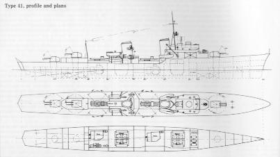

Plans of Type 41 Destroyer
Sketch from "German Destroyers of World War Two" by M.J. Whitley
