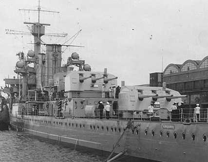

Overhead view of light cruiser Köln about 1930
Note the offset turrets and the amidships 8.8 cm/76 SK C/32 AAA guns
U.S. Naval Historical Center Photograph # NH 98267

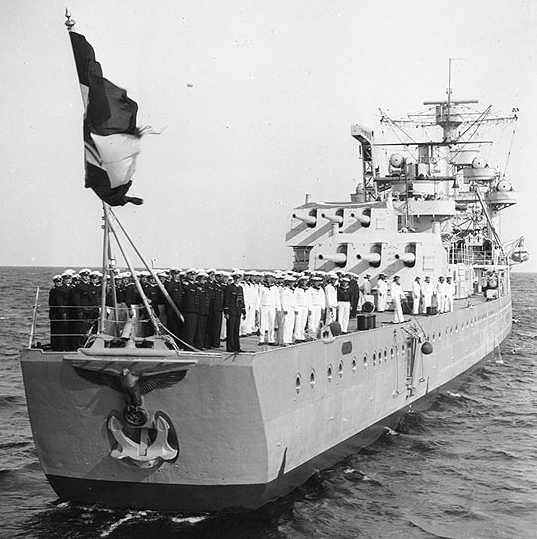

Manning the rails on light cruiser Köln in 1935
U.S. Naval Historical Center Photograph # 242-HB-14598a55

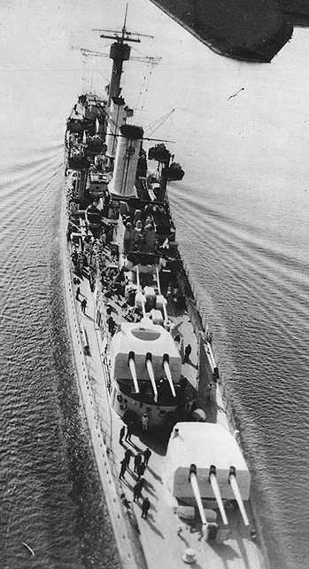

After turrets of Königsberg while docked at Gdynia in 1935
U.S. Naval Historical Center Photograph # 80967

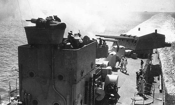

Stern of Königsberg showing after director, 8.8 cm AA guns and 15 cm turrets
U.S. Naval Historical Center Photograph # 80997
