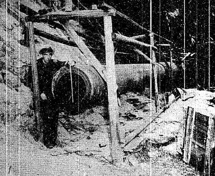

48 cm/45 (18.9") 5th Year Type as found in December 1945 at Kamegakubi Proving Grounds
Photograph from "US Naval Technical Mission to Japan report O-45 (N)"
