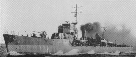

Japanese Escort Vessel Number 8
(Kaikoban Class II Type D)
