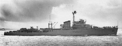

Light Cruiser RNN Tromp

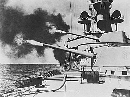

De Ruyter firing circa 1941
United States Office of War Information, Overseas Picture Division, Washington Division; 1944
Library of Congress Photograph ID LC-USE613-D-010622
