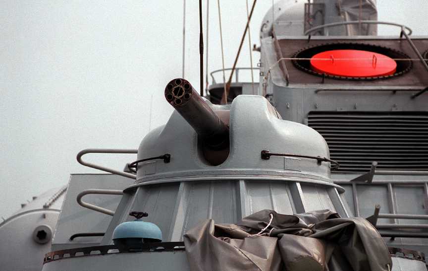

30 mm/65 (1.2") AK-630 aboard USNS Hiddensee
U.S. Navy Photograph No. DN-SC-93-05853

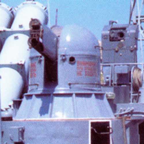

AK-630M1-2 Roy on the small missile ship P-44

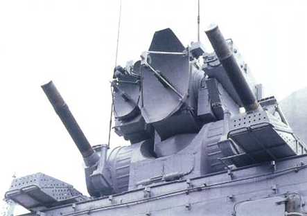

30 mm Kortic mounting on Neustrashimy
