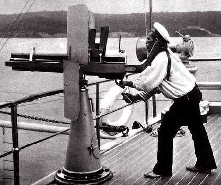

These Hotchkiss weapons were crank-operated, five-barrel revolver-style rotating guns, externally somewhat similar to a Gatling gun but having a different ammunition feed system.
In addition to the five-barrel weapons, the Russians also purchased 37 mm/1 (1 = single barrel) Hotchkiss guns in 1883.  By 1901 some 276 guns of this type were in service.  As these single barrel guns were easier to manufacture than the multi-barrel guns, they became standard equipment in the Russian Navy until 1905.  In that year, combat during the Russo-Japanese War proved these weapons to be ineffective and they were quickly removed from most larger ships.  During World War I and the Russian Civil War they were widely used to arm light ships and river craft.  Several of these weapons survived to serve in World War II on the ships of the Pinsk River flotilla.
These guns had monobloc barrels with a vertical blade type breech mechanism.

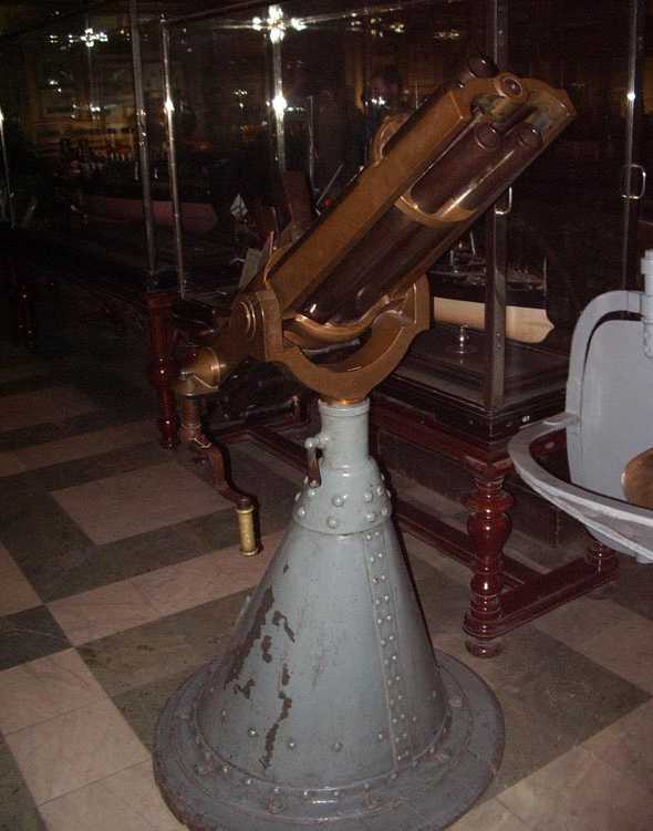

Five-barrel 37 mm/5 Hotchkiss Gun
Five-barrel 37 mm/5 Hotchkiss gun now at Central Naval Museum, St. Petersburg, Russia
