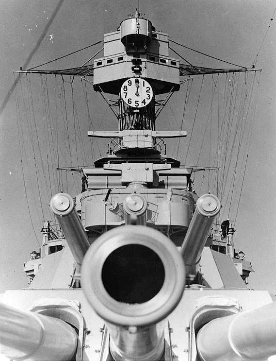

Forward Turrets of USS California BB-44 in 1938
Note the Range Finders and Range Clock
U.S. Naval Historical Center Photograph # 80528
