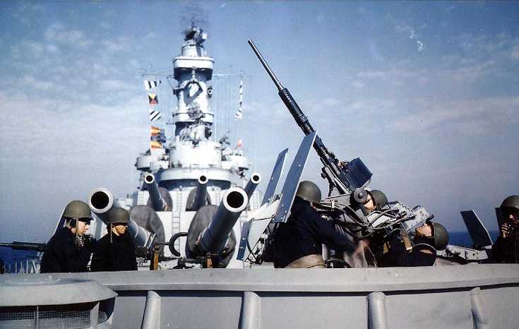

20 mm Oerlikon guns on USS Iowa BB-61 about 1943
The crewman on the left of the elevated gunmount is adjusting the trunnion height
Note the Mark 14 Gunsight and that the censor has obscured the radar antennas on the director and mast
U.S. Naval Historical Center Photograph # K-16469
