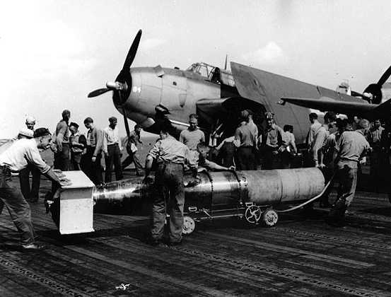

Mark 13 Torpedo being loaded on USS Wasp CV-18 in 1944
Mark 13 torpedo
This picture clearly shows the "pickle barrel" nose drag ring and the "ring tail" tail shroud

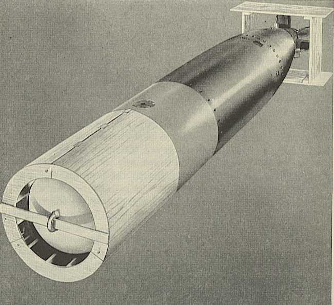

The addition of the nose drag ring improved aerodynamic performance by stabilizing the torpedo in flight and reduced air speed by about 40 percent.  It also acted as a shock absorber when the torpedo struck the water.  The tail shroud ring improved the water run by reducing hooks and broaches and by eliminating much of the water roll which had characterized the earlier Mark 13s.  Hot, straight and normal runs now approached 100 percent.  To speed availability of the much improved torpedo, the Bureau of Ordnance had tail assemblies built with the shroud ring attached and then shipped these to the fleet for upgrading the existing inventory.  By the fall of 1944, the modified torpedo was in general use by the front-line carrier units which were enthusiastic in their praise.  On one occasion in early 1945, six torpedoes were dropped from altitudes between 5,000 and 7,000 feet (1,500 to 2,100 m).  Five out of the six were observed to make their runs hot, straight and normal.  By the end of the war, the USN considered the Mark 13 to be the best aircraft torpedo produced by any nation and it remained in service until 1951.

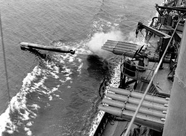

Typical Destroyer five-tube Torpedo Mount
Ship Class Used On Destroyers and Atlanta (CL-51) Class Cruisers
Date Of Design 1934
Date In Service 1935
Weight Mod 0:  3,438 lbs. (1,55 kg)
Mod 3:  3,841 lbs. (1,742 kg)
Overall Length Mod 0:  22 ft 7 in (6.883 m)
Mod 3:  24 ft 0 in (7.315 m)
Negative Buoyancy 1,260 lbs. (572 kg)
Explosive Charge Mod 0:  494 lbs. (224 kg) TNT
Mod 3:  801 lbs. (363 kg) TNT or 823 lbs. (373 kg) HBX
Range / Speed Mod 0
   6,000 yards (5,500 m) / 45 knots
   10,000 yards (9.150 m) / 33.5 knots
   15,000 yards (13,700 m) / 26.5 knots
Mod 3
   4,500 yards (4,100 m) / 45 knots
   9,000 yards (8,200 m) / 33.5 knots
   14,000 yards (12,800 m) / 26.5 knots
Power Wet-Heater steam turbine
Guidance Mark 12 Mod 3 gyro
Notes:  The standard destroyer weapon of World War II.  Replaced the earlier Mark 11 and Mark 12.  Remained in service as long as US destroyers carried 21" (53.3 cm) torpedo tubes.  About 9,700 produced between 1940 and 1944.

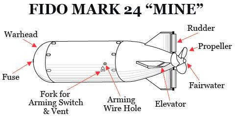

19" (48.3 cm) Mark 24
Sketch copyrighted by Center for Strategic & Budgetary Assessments
Ship Class Used On Aircraft
Date Of Design 1941
Date In Service 1943
Weight 680 lbs. (308 kg)
Overall Length 7 ft 0 in (2.134 m)
Explosive Charge 92 lbs. (42 kg) TPX or HBX
Range / Speed 4,000 yards (3,660 m) / 12 knots
Power Electric Battery
Guidance Passive Acoustic Homing
Notes:  A very small anti-submarine homing torpedo.  Also known as the Mark 24 Mine and as "Fido."  Homing was by four crystal hydrophones arranged around the body with simple guidance system that steered towards the loudest noise.  Launch parameters were 125 knots from 250 feet (76 m).
