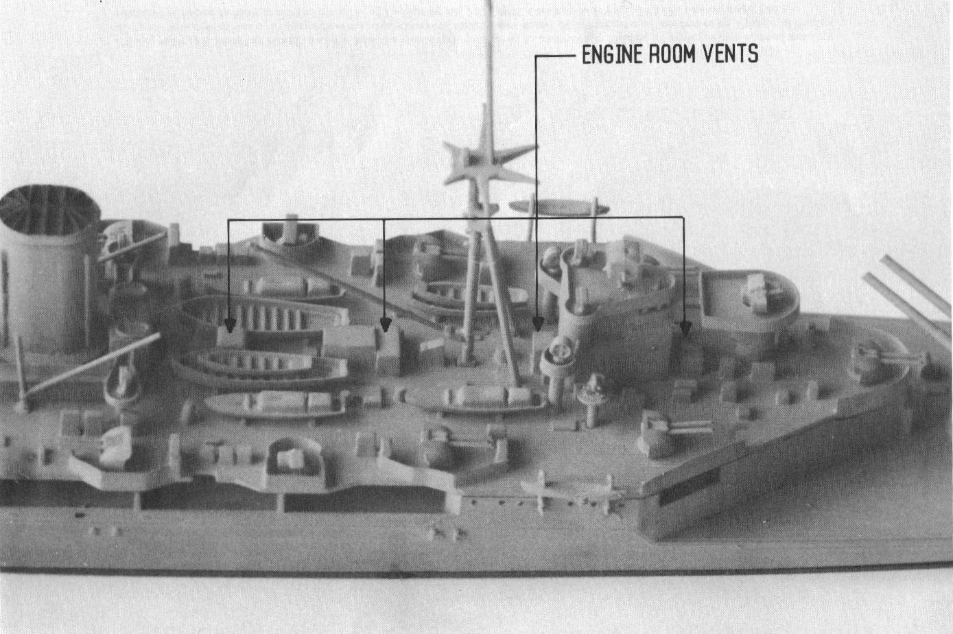

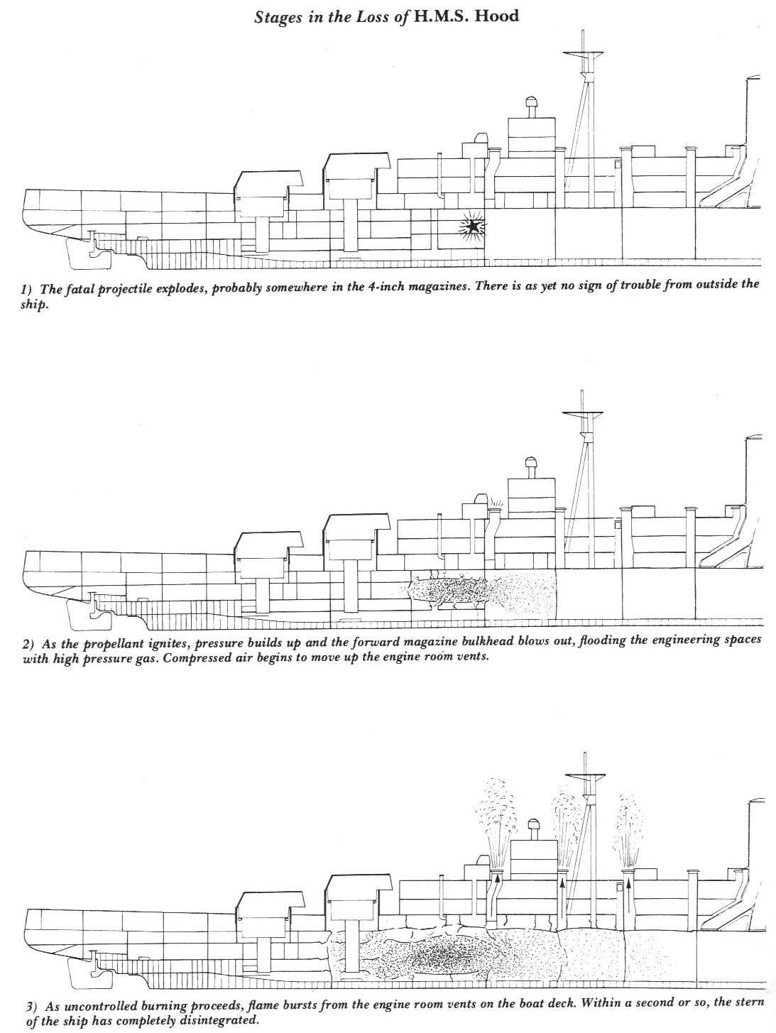

In the absence of any other possible energy source, like the boards, I have concluded that it is most probable that Hood was relatively slowly rent apart over a period of perhaps a second by the uncontrolled burning of the propellants in her after magazines.  Although the actual position of the hit and the subsequent path of the projectile through the ship are problematical, it is clear that there are several routes by which one of Bismarck's 380mm shells might have reached the after magazines.  Again, like the boards, I have also concluded that the most probable cause of the final blast was a hit from a single 380mm projectile from Bismarck.
The general consensus of witnesses was that the explosion seemed to originate in the vicinity of the mainmast, some distance forward of the after magazines.  The orthographic diagram shows that there is one place where a shell falling slightly short could have passed through the after engine room and detonated in or near the magazines located immediately adjacent to its after bulkhead at station 280.  Yet another possibility is that it passed through the 178mm belt before detonating in essentially the same place.  If this occurred, and ignition of the propellant in the magazines followed from it, then a large part of the rapidly expanding gas bubble would have taken the path of least resistance and vented into the engineering spaces immediately forward of this area.  For a time the sheer inertia of Hood's structure would have slowed expansion in any other direction.  Once the expanding gasses had reached the engine rooms, the quickest exits to the outside would have been the series of massive exhaust vents located on the centerline immediately forward and aft of the mainmast.  These huge ducts, changing in size and shape as they rose through the ship ended in roughly square vents 1.8 meters on a side on the boat deck.  It was as spectacular, near-vertical columns of flame from these vents near the mainmast, foreshortened to observers on surrounding ships, that the explosion first became visible.  Shortly thereafter, the entire stern of the ship exploded.90
At the time of the blast, the Boards of inquiry calculated the "X" 15-in magazine contained about 49 tons of cordite, "Y" magazine contained 45 tons, and the 4-in magazines contained about 18.5 tons.  The uncontrolled burning of this quantity of propellant in the after magazines might have slowed briefly as the volume of the engineering spaces served as a space into which the gasses could expand, and as the vents directed much of the combustion products outboard. But although this expansion and venting could temporarily relieve the pressure, it could never be enough to prevent an explosion from eventually tearing the ship apart.91  Ironically, the chemical energy stored in the battlecruiser's after magazines - enough to lift her enemy over a kilometer in the air had it been employed to do so - had instead destroyed the Hood herself.
Photograph of a model of Hood showing the engine room exhausts through which the final explosion probably first vented itself.  The model is Tamiya kit no. 7827-950.
Click on this sketch for a larger image.
