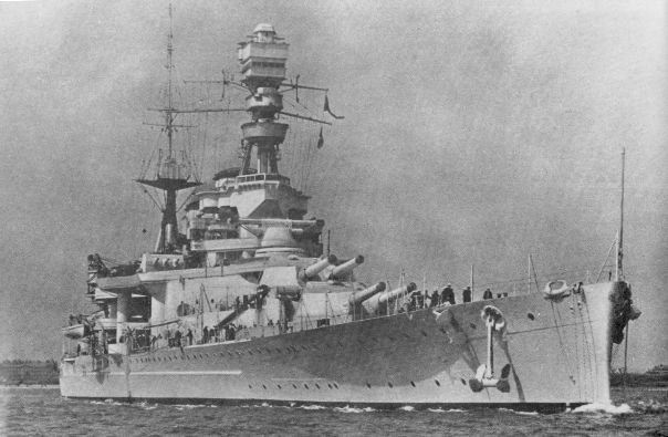

HMS Repulse in 1936, fresh from refit.
Photograph courtesy Illustrated London News.
