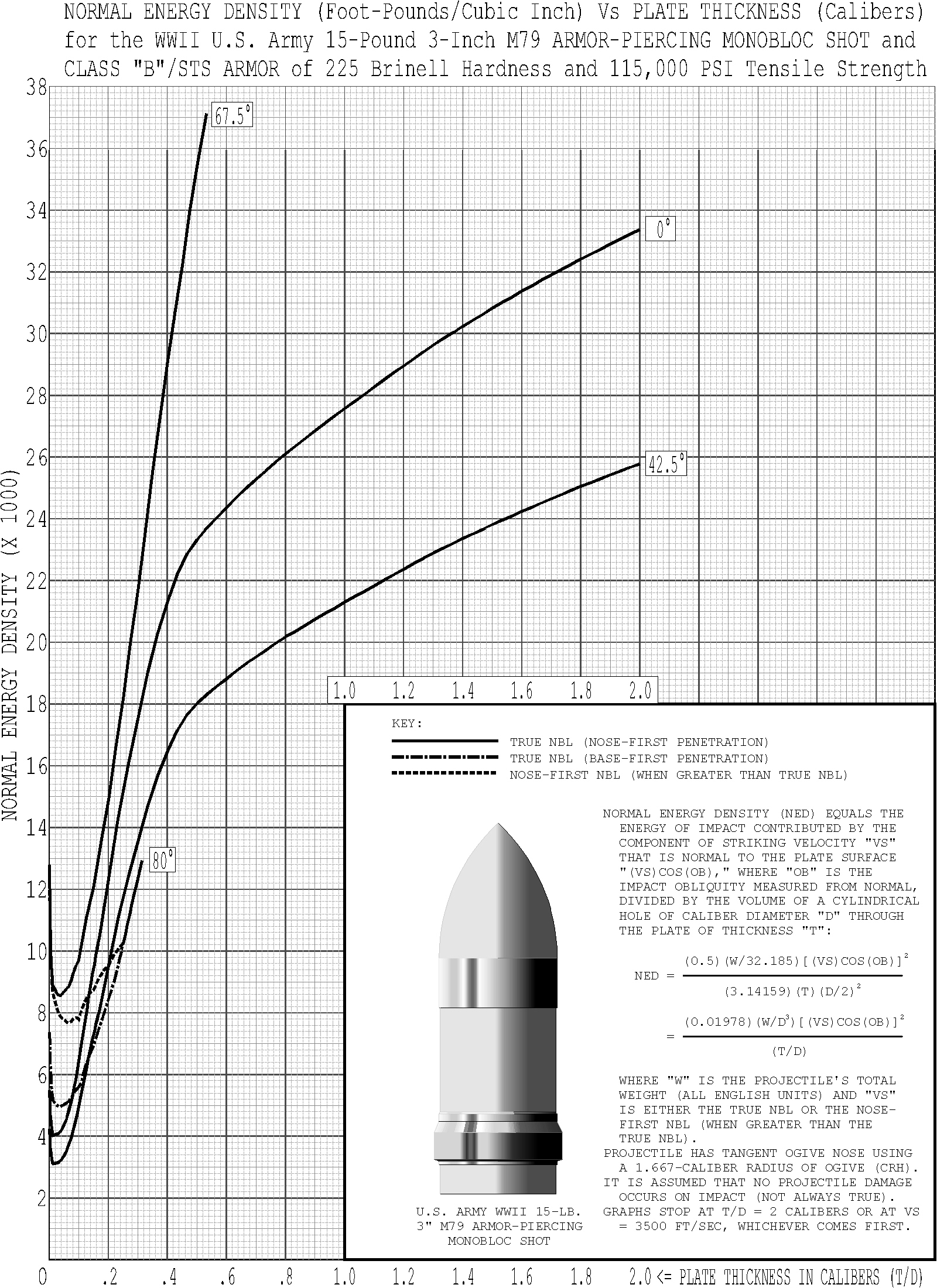

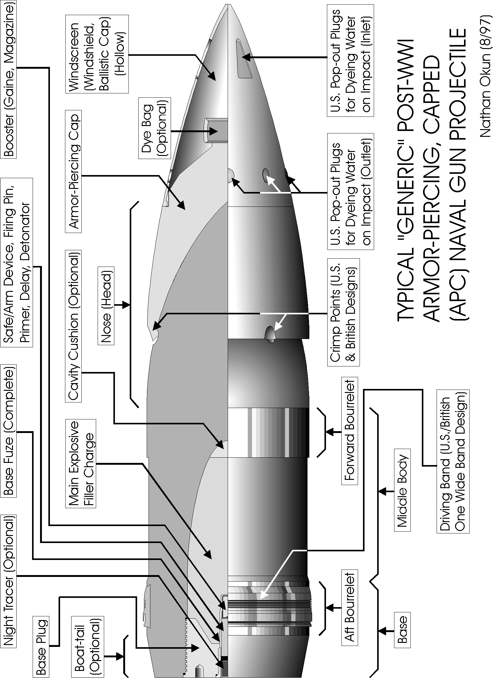

The following figures "NORMAL ENERGY DENSITY VS PLATE THICKNESS" and "TYPICAL POST-WWI APC PROJECTILE" give some idea of the simple army 3" M79 projectile design and its differences from the more complicated WWII naval armor-piercing projectile designs.

(8) True NBL Energy Density. In an attempt to graphically show how the penetration resistance of the plate as defined by the NBL is varying with all of the applicable parameters (T, D, OB, VS, PQF, %EL), various methods have been used. The U.S. NBL developed the Thompson "F" Formula which directly related the NBL to an empirical parameter "F" (actually "(F)COS(OB)" to making graphing of impacts at non-zero OB values easier) in a simple formula. This value of "F" was then used to calculate the energy needed to penetrate as a function of OB and T and the results plotted. I modified their graphs somewhat to the following equivalent form. As the horizontal axis, with zero in the lower left corner, I linearly labelled the axis T/D, increasing toward the right. As the vertical axis on the left edge, I linearly labelled this axis "NORMAL ENERGY DENSITY" again with zero in the lower left corner and increasing as one went up. The Actual Energy Density (AED) is the projectile's kinetic energy divided by a circular, cylindrical hole of projectile diameter and total plate actual thickness in depth, which is the minimum possible hole size to let the projectile through the plate--obviously, as OB increases over 45o, an actual hole will get more and more oval until it is a long slot rather than a round hole, but by using this single simple formula one can more easily see how the energy needed to penetrate changes with both T and OB for a given plate type (constant PQF and %EL). The AED is calculated as follows:
AED = (0.5)(W/32.185)(VS)2/[(3.14159)(D/2)2(T)] = (0.01978)(W/D3)(VS)2/(T/D)
where "W" is the projectile's total weight in pounds and 32.185 is the acceleration of gravity in feet/second2 to change weight units into mass units (note when using metric "kilograms" for W this division is not necessary as kilograms already are in units of mass; "newtons" are the metric equivalent of English pounds). Here, VS is usually the True NBL, though sometimes other values of V are of interest (the Energy NBL, for example). The dimensional units of AED are English "foot-pounds/cubic inch," though metric "newton-meters/cubic centimeter" can be used by merely changing the numerical constant from 0.01978 to 0.63662 when T and D are in centimeters, W is in kilograms, and VS is in meters/second. The Normal Energy Density (NED) is the same but only using that VS component pointing directly into the plate at right angles; that is, NED = (AED)COS2(OB), which greatly compresses the vertical scale when comparing various values of OB in this formula/graph. These graphs are directly comparable to the Thompson "F" Formula-based graphs of functions of "F" used by Dr. Hershey's organization at the U.S. NPG.
EFFECTS OF PLATE THICKNESS CHANGES AT NORMAL OBLIQUITY
When the normal obliquity True NBL impact energy density (AED = NED) of the undamaged 3" M79 projectile impacting standard U.S. Navy 225 Brinell WWII STS is plotted versus T/D and the data smoothed and a least-squares fit made for plates of T/D values from 0.005 to about 3.5 calibers, which about covers the entire range of plate thicknesses we need to be concerned with, one discovers that the resultant empirical curve looks amazingly like a square-root sign with a curved top instead of a flat one or, alternatively, a check mark with the small leg on the left and the long upward right leg being straight for a time and then curving to the right to get more and more horizontal, though it never quite gets there. All penetrations are nose-first, of course.
What does this signify?
The short left leg of the check mark is from T/D of zero to about T/D = 0.01 with NED dropping from about 5,800 at T/D = 0 to about 4,200 at T/D = 0.01.
The bottom left corner of the check mark is rounded and begins at about a T/D = 0.01, hits bottom in a "U" shape at about T/D = 0.015 and an NED of about 4,020, and then begins to curve up and merges with the bottom of the long right leg at about T/D = 0.085 and NED of about 5,700.
The straight lower portion of the long right leg of the check mark curve starts at T/D = 0.085 and goes up in a nearly straight line to about T/D = 0.275 and NED of about 16,300.
The very gradually curving portion rises less and less steeply from T/D = 0.275 to T/D = 0.35 and NED of about 20,400.
At the T/D = 0.35 point there gradually begins a distinct knuckle in the NED curve until it reaches T/D = 0.465 with NED of about 22,900, bends over abruptly, and it then rises much less steeply and very gradually flattens out in a more and more shallow, slightly-concave-downward, but still increasing, curve until it hits NED of 38,936 at T/D = 3.457, where we stop since we have hit my self-imposed 3500 feet/second maximum VS (the curve could be extended to higher values of T/D, but the results get more and more inaccurate due to heating and shock effects on the projectile and plate changing the rules of penetration if we go too far). Usually we do not need to worry about plates over 2 calibers thick in our study (at least as long as we are dealing with steel and not wrought iron).
The range of T/D < 0.01 has resistance to penetration being almost entirely due to the very wide trampoline-like dishing of the plate, which only after stretching back some distance splits open radially in the center to form triangular flaps or "petals" that are folded backwards out of the projectile's path into a ring of "teeth" surrounding the central hole at the top of the high, cone-shaped bulge at the plate back. As the plate gets thicker, the material gets more rigid, the dished area contracts toward the central hole, and the NED actually decreases (the only plate thickness region where this occurs), making the NBL almost constant over the entire region.
The graph's U-shaped NED region from T/D = 0.01 to T/D = 0.085 has the increasing thickness of the petals causing them to be more and more difficult to bend back and eventually this increasing petalling energy requirement overcomes the decrease in energy as the dishing area contracts and the combined dishing/petalling energy needed to penetrate increases again.
The nearly straight-line increase from T/D = 0.085 to T/D = 0.275 is caused by the steadily increasing energy needed to bend back the entire-plate-thickness petals (dishing is about constant here and for larger thicknesses), which has an energy requirement that increases so fast that the penetration is nearly linear with the increasing kinetic energy of the projectile. If we assume that the energy required to bend back any narrow thickness layer within a petal is the same for all such layers from the front surface to the back surface (Force of Resistance = (Constant1)(T)) and that no bending can happen until the entire plate thickness is bent back as a unit (Distance Moved = (Constant2)(T)), then the minimum energy needed to penetrate in the form of "Work" (= (Force)(Distance Moved Against That Force)) equated to the projectile's Kinetic Energy (= (VS2)[(Weight/2)/(Acceleration of Gravity)]) is, when VS = True NBL,
(0.5)(W/32.185)(True NBL)2 = [(T)(Constant1)][(T)(Constant2)] = (Constant3)(T)2
T = (Constant4)[SQRT(W)](True NBL) = (Constant4)SQRT[(W)(True NBL)2]
so the increase in complete penetration plate thickness T with VS = True NBL is linear, which means it increases with the square root of the projectile's Kinetic Energy, requiring a rapidly increasing amount of energy per unit of plate thickness increase as the plate uses an all-for-one-and-one-for-all mutual support method of resistance. Note that the petal is a point at its central tip and wide at its base bordering the hole, so the energy needed to bend back a petal is mostly used up bending the petal near the edge of the hole--if the central petal region containing the petal tips is sheared off by, say, a tapered flat nose shape, only if the shearing is done near the edge of the hole (a wide flat region in this case) will there be a significant change in the energy needed to penetrate. For this reason, blunt nose shapes only rapidly change the energy needed for normal-impact penetration of most plate thicknesses when they get very blunt; small changes from the M79 projectile nose shape only have small effects on penetration.
This linear T versus VS case is very different from an ideal pure Kinetic-Energy-dependent complete penetration, where each unit layer of the armor is completely independent of any other layer and has an equal energy absorption. In this case, penetration through a thickness T is merely the sum of the energy needed to penetrate each layer in succession; that is, T = (Constant)(W)(VS)2, which has a much more rapid quadratic increase of T with VS = True NBL.
No actual plate impacts follow either extreme, though pure petalling (and plunching out a full-plate-thickness armor plug by a flat-nose projectile) most closely approximates the linear T proportional to VS case and pure "sideways wedging" (also called "plastic deformation"), see below, inside very thick plates most closely approximate the T proportional to (VS)2 case. The widely-used French 1890 DeMarre Nickel-Steel Armor Penetration Formula has a single intermediate exponent for T versus Kinetic Energy of T = (Constant)[(W)(VS)2]0.71429, which is almost exactly in the middle between the linear (exponent = 0.5 = SQRT()) and quadratic (exponent = 1.0) T versus VS = True NBL cases. While not very good for very thick or very thin plates, once the Constant had been established for a given plate type (using the "DeMarre Coefficient" for the given armor type), the formula gave rather good results for medium-thickness plates of circa 0.25-0.75 caliber thickness at normal obliquity.
At T/D = 0.275 another factor gradually begins to occur that replaces the previous increase in petal thickness, but causes a similar phenomenon to happen at the plate face: A narrow-rimmed, shallow "splash" or "coronet" ringing the initial impact site on the plate face; what I call "cratering" of the face, since the result looks just like craters on the moon. This is the first sign that the material deeper into the plate is now inhibiting the armor material near the face from being pushed back and thus the material is pushed sideways and bulges the face up into a mound with the jagged coronet ringing the central hole. As plate thickness increases over 0.275 calibers, this crater deepens, increasing the face bulge, though the coronet rim stays about the same. Petalling is now happening only in the back layer behind the deepening cratered layer on the plate face, being about 0.25-0.275 caliber thick measured from the plate's back surface. The energy needed to form the crater is less than that needed to bend back thick petals, but still requires the pushing of the entire mound of displaced material sideways and upward against the increasing resistance of the thickening plate material to the sides of the hole, so the rate of increase in the energy curve gradually begins to get flatten out--a horizontal line would mean that the energy needed per unit thickness increase is constant, which is not occurring here, though.
At T/D = 0.35, the petals are at maximum thickness at the plate back and the cratered layer on theplate face is at maximum depth, too, at about 0.1 caliber deep, so from now on the additional energy needed to penetrate is due to wedging the plate material in the center of the plate sideways by the expanding diameter of the angled nose surface to form a very wide, shallow bulge in both the plate face (surrounding the higher crater bulge) and back (surrounding the petal bases) made of the displaced material (the thicker the plate, the more material is pushed into this bulge, but the less noticable it is). Between 0.35 calibers and 0.465 calibers, the primary method of plate resistance is rapidly changing from cratering/petalling, which are now absorbing a more-or-less constant amount of impact energy regardless of plate thickness for all plates about 0.425-0.45 caliber and thicker, to pure sideways wedging and the energy needed per unit depth is now quickly flattening out into a constant amount since each further increase in depth goes to forcing the displaced armor material sideways in the plate center, which is more-or-less independent of any material farther away; that is, the resistance is changing to one more like swimming in a pool of water, with the only material affected being the material near the forming tunnel into the plate, not the material of the entire plate thickness such as when the bending petals of total plate thickness was the primary method of soaking up projectile energy.
At T/D = 0.465 and above for all further thickness increases to the 3.457 caliber STS thickness maximum, the central plate layer where wedging is the main mode of penetration completely takes over, which results in a roughly constant energy per unit depth to continue to penetrate, so the increase in energy requirements flattens out markedly. However, it does not quite become horizontal because some energy is going into shock waves, heating of the plate and projectile, lengthwise compression of the projectile and plate materials which make the necessary hole slightly wider, and so forth, and these kinds of effects dissipate more and more of the available energy and thus slowly and steadily increase the energy requirement to penetrate, but to a progressively smaller degree as plate thickness increases (smaller as long as projectile and plate material is not shattering or melting, that is!). Also, the Laws of Thermodynamics rear their ugly heads and entropy must be increased, wasting even more energy. (By the time the projectile has its striking velocity high enough to penetrate 4 calibers or more at normal obliquity (VS is over 3700 feet/second), these "secondary" effects have grown to become the primary effects and projectiles will either always shatter due to impact shock or they and the plate begin to melt under the impact energy being transferred from one to the other, drastically changing the rules for penetration--luckily we do not need to worry about this for our purposes!)
Note that this general normal-impact curve shape is true to more pointed and blunter projectile nose shapes, though they gradually distort the curve by shifting the NBL values where the methods of absorbing the projectile energy change and these changes also raise or lower the NED values at these transition points.
More pointed projectiles than our standard M79 nose shape will have a slightly lower NED for each of the normal-impact curve transition points, with the difference for the most pointed designs (for example, some WWI Common projectiles with ogival noses of about 7-caliber radius of ogive) being about 15% lower than with the standard M79 nose shape; however, the T/D values of the transition points are do not change significantly. The M79 projectile nose shape is thus a good example of the typical pointed nose.
For blunter noses than our standard M79 nose shape, the change in the normal-impact curve shape is also gradual, but eventually much more extreme for very blunt noses (pure flat noses being the limit here), with the NED value needed for penetrating thick plates increasing more and more rapidly as nose shape flattens out, indicating that the nose is having a more and more difficult time forcing the plate material sideways out of the projectile's path. (Indeed, I do not yet have a ceiling for this increase, since undamaged projectile impacts are virtually impossible against STS-type armor when T/D increases above about 0.75, which is frustrating!) As with thick plates, the NED for very thin plates also rising rapidly (though not as fast or as far as the thick plate increase does) because a blunt nose has trouble starting a tear in such thin, flexible material (as anyone who has tried to tear open a foil or plastic film candy wrapper can testify!). In either case, the increases are gradual until a projectile nose gets very blunt, with most of the NED increase at any plate thickness being in the small change from a tapering flat nose of about 85% flat to a 100% flat nose--even a slight wedging ability has big effects.
Also as projectile nose bluntness increases, the minimum-energy U-shaped NED region widens rapidly, with its minimum-NED point moving toward thicker and thicker plates and increasing considerably in value, up to just over NED of 11,000 at about T/D = 0.1 for the 85% flat nose shape. This is also due to the blunt nose having trouble starting a tear in thin plates so that petalling can begin, which increases the depth of dishing prior to petalling taking over and raises the entire NED curve in that region. The center of the impact region is now undergoing failing by shearing out a disk-shaped armor plug of less than projectile diameter in width and, due to geometry/force laws, about half of its width in thickness (what is termed "plugging"), with only the outer ring of armor material outside of the plug region being wedged sideways or bent back as petals, but, as mentioned, this outer ring is still absorbing most of the energy as long as the plug width is not cutting into the final base region so that the petals are still of maximum thickness, even if only stubs. At the extreme, a pure flat nose will completely slice off the petals at their bases, forming a maximum-size, caliber-width, punched-out plug of about half-caliber thickness, prior to them being able to bend back at all, which abruptly drops the minimum NED value for this final bluntness increment to only about 8,350 at T/D = 0.55 caliber, considerably better than the standard M79 nose shape for such medium-thickness plates. Also, for a true flat nose, the U-shaped NED curve region completely replaces all other NED curve regions up to about T/D = 0.9 (possibly for plates even thicker than this, but I have no data at present).
As mentioned above, the punched-out plug thickness seems to be limited by geometry to about half of the plug's diameter, so a plate thicker than about T/D = 0.55 for a true flat-nosed projectile--where resistance is a minimum due to the plug edge being easier to tear out of the plate than the stretching, dishing, bending, wedging, and petalling of other armor thicknesses--rapidly increases its resistance as the entire plate thickness must be now be bulged back and stretched over an increasingly wide area until the material directly in front of the projectile is thin enough to punch out as a plug--this is a very strong inhibition to using such projectiles when thicker armor might be hit, even though they do so well against circa-half-caliber plates (this is why the Japanese put the rather blunt, but not flat, "cap head" over the tapered flat nose of their "diving" post-WWI Type 88 and Type 91 AP/APC projectiles; the cap head would be knocked aside at high obliquity, where the tapered flat nose's sharp edge would dig into the impacted material and impede ricochet and thus be useful against any plate thickness and against the surface of the ocean, but the cap head would remain attached at low obliquity long enough to act as a regular, though rather rounded or bluntly-pointed, projectile nose, where a flat nose was so bad against thick armor).
Interestingly enough, at around T/D = 0.2-0.25 and at normal obliquity, changing the projectile nose shape has rather little effect, as all of the NED penetration curves from projectiles with long needle points to those with flat cylinder tips come within about 10-15% of each other there and many cross each other (some NED values going up with increasing plate thickness and some going down). As this is also the same plate thickness region where the minimum value in M'(OB,T) for any given T/D occurs for all impacts over 45o obliquity, especially at the highest obliquities, with the M79 projectile nose shape (and for nose shapes similar to it, which were widely used), the result is that this plate thickness is not one where you would want to design your protection around if you know the size of the enemy's guns; even a small reduction in thickness might make your protection stronger in some cases! (A similar, but more spread-out, cross-over region occurs in a T/D range of 0.75-0.85 for all nose shapes, with the many of the NED curves going in the opposite direction compared to the T/D = 0.25 region.)
