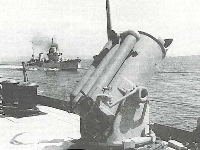

Depth Charge Projectors of World War II
Trainable DCT for 100 kg (220 lbs.) DC
This DCT used an arbor and was normally fired at a 45 degree angle, although it could be loaded when horizontal
Photograph from Aldo Fraccaroli Collection
There were some broadside DCT but no ahead-throwing weapons such as Hedgehog during World War II.

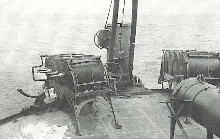

Anti-Submarine Torpedoes
DC racks and Towed Torpedo on Torpedo Boat Lupo in May 1942
These were towed torpedoes, somewhat similar to a paravane.  The basic design was an unpowered cylindrical body attached by a cable to the stern of the ship and trailed at depths between 120 and 300 feet (37 to 90 m).  There were several versions, with the differences being the total size and warhead weight.  These torpedoes were mainly contact-fuzed, although a magnetic version appeared before the Armistice.
