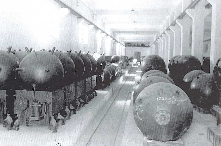

Bollo P125/1935 (British Designation "H")
Originally designed by Admiral Gerolamo Bollo of the Italian Navy and manufactured by Pignone.  Charge of 276 lbs. (125 kg).  Used six Hertz Horns.  The shell could withstand a maximum of 100 feet (30 m).  Some of these used antennas during the war.  Designation may have been P125/1933.
Italian Mines in a warehouse at Partheni, Leros, possibly P125/1935 type

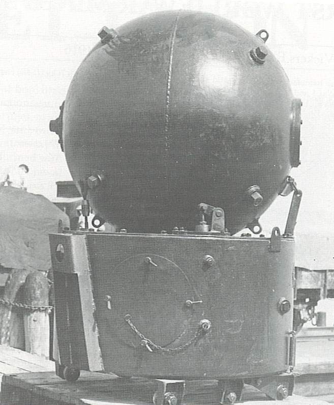

P200 (P5) Mine and Anchor
The Hertz horns are blanked off

P200 (P5) (British Designations "IK" and "IKA")
Spherical mine of 46 in (1.17 m) diameter manufactured by Pignone since 1936.  Weight of 2,535 lbs. (1,150 kg) with a charge of 441 lbs. (200 kg).  Used nine Hertz Horns.  Designed for use against both submarines and surface ships with a maximum depth of 330 feet (100 m).  Mooring cables of 360, 1,170 and  2,670 feet (120 m, 520 m and 820 m) were used.  There was a late-war variation with acoustic triggering and eight Hertz horns, this was the "IKA" version.

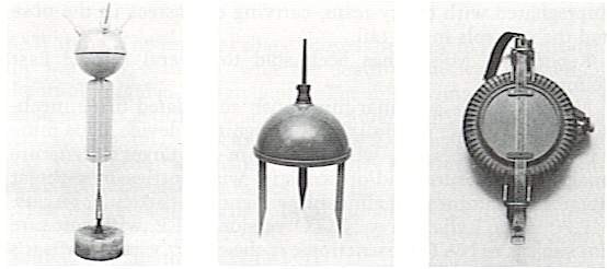

Tecnovar Mines
From left to right:  MAL/17, MAS/22 and EPR 2.5
Photograph copyrighted by Tecnovar
EPR Series (1.2, 2.5, 3.6 and 6)
An anti-invasion mine manufactured by Tecnovar, these are flat disks in shape.  The number indicates the explosive charge (1.2, 2.5, 3.6 or 6.0 kg).  Fuzing is electronic and the mines saw service introduction about 1981.  The EPR 2.5 weighed a total of about 13 lbs. (6 kg).  This mine was 10.2 inches in diameter and 3.5 inches thick (26 x 9 cm) and was said to be capable of blowing a 9.8 in (25 cm) diameter hole in a 1.2 in (3 cm) thick steel plate.
MAL/17
Another anti-invasion mine manufactured by Tecnovar, these were introduced in 1984.  MAL/17 is a contact mine with three horns on top of the sphere containing a 17 kg charge.  Total weight of 22 kg.
MAS/22
This is a variation of the MAL/17 that is a half-spherical mine with three stakes that allow it to be driven into a river bed or beach.  Total weight of 22 kg with a 17 kg charge.
