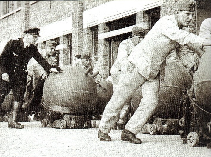

Russian Model 1908 Mine
Photograph courtesy of Gary Cartwright
German sailors of the 2nd Flotilla S-Boote with captured Russian Model 1908 Mines
Photograph taken at Ostende, Belgium ca. 1944
Établissement de Communication et de Production Audiovisuelle de la Défense (ECPA D) Photograph

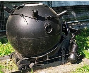

Model 1908
Moored contact mine.  Extremely successful mine.  With slight modifications used by the Russian/Soviet Navy until 1960s.  Total weight 1268 lbs. (575 kg), charge was 254 lbs. (115 kg) of TNT, used 5 Hertz horns.  Maximum depth - 360 feet (110 m).  Main Russian mine at the start of World War I.

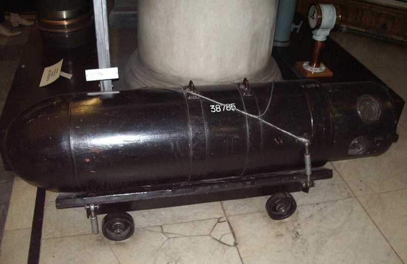

AMD-2 500 Mine now at Central Naval Museum, St. Petersburg, Russia
