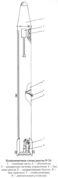

Missile was single-stage, liquid fueled, with four chamber engine and a monobloc warhead.
Sketch of R-21 Missile
