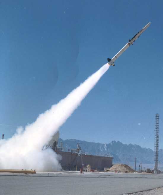

SM2-ER being fired from China Lake
Photograph courtesy of Gus Shull
