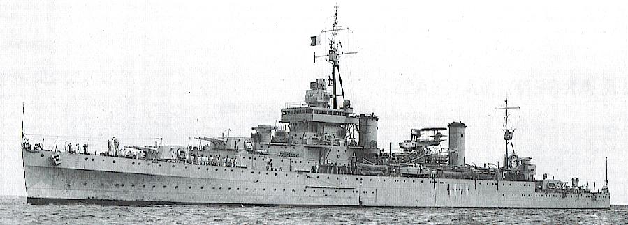

La Argentina in 1950
See La Argentina gun
