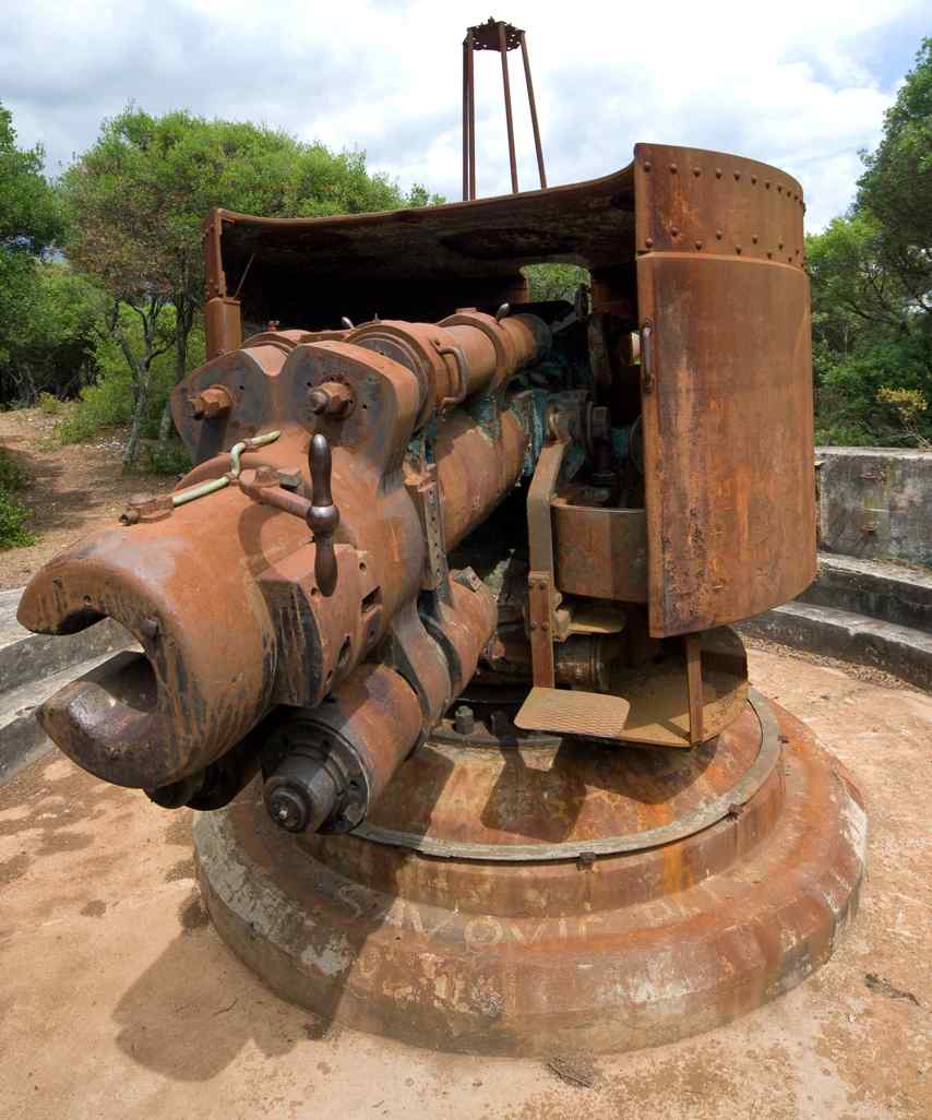

15 cm/50 Skoda gun at Batterie Madonna on the island of Veli Brioni near Pula, Croatia
This is only remaining complete gun of the four-gun battery
The engravings on this gun have been obscurred by rust, but it appears that this is gun serial number 15 and was manufactured in 1912
Photograph copyrighted by Caspar Vermeulen and used here by his kind permission

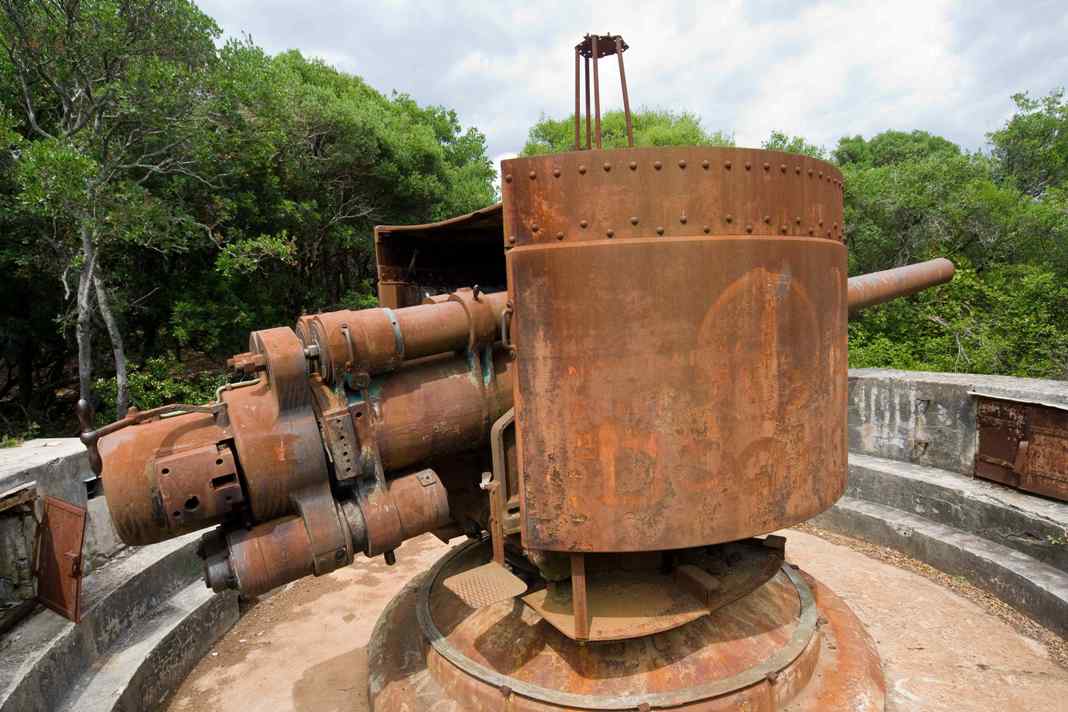

Rear view of above weapon.  Opening in casemate appears to have been enlarged, allowing higher elevations
Note sliding breechblock, typical of Krupp and Skoda weapons of this period
