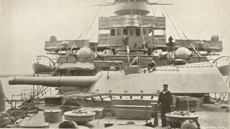

Forward 12" (30.5 cm) mounting
Photograph courtesy of Brian Cave and Paul Benyon

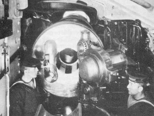

12"/35 (30.5 cm) Mark VIII gun breech on HMS Illustrious
Note the three-motion breech design
Photograph copyrighted by John Roberts

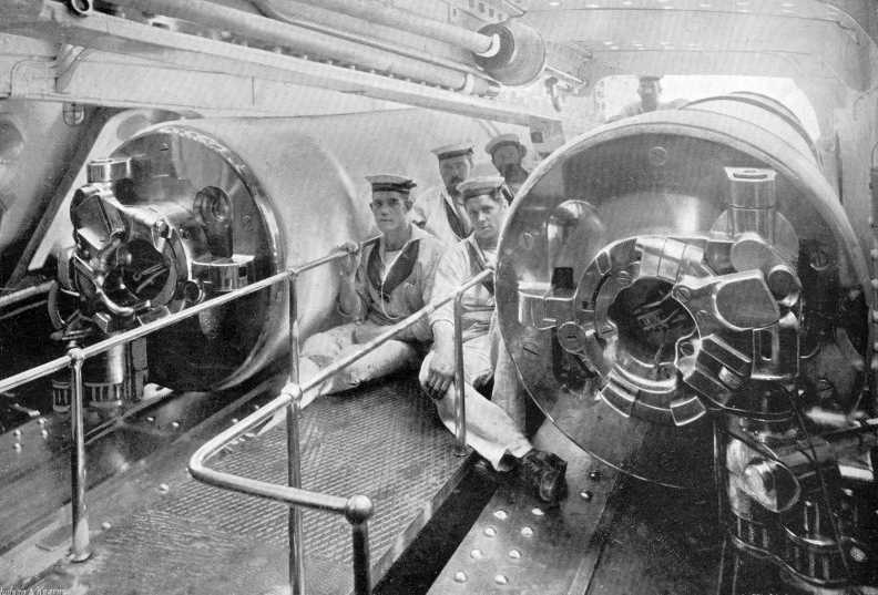

12" (30.5 cm) Gun Breeches on HMS Prince George
Note the hand rammer on the roof
Photograph courtesy of Paul Benyon and Dave Perkins
