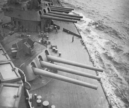

HMS Nelson in 1940
Note the UP launchers on the top of B and X turrets
IWM Photograph
