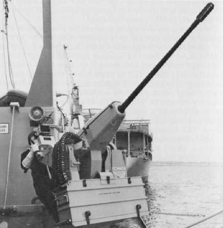

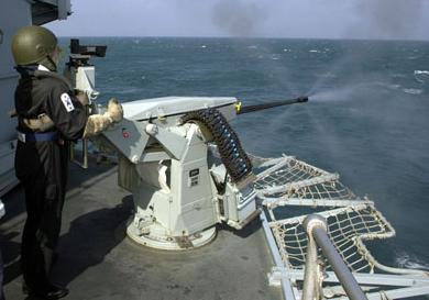

This is the Oerlikon KAA cannon used in a manually-controlled mounting built by BMARC (British Manufacture and Research Company) under the designation A41/820.  Installed on many British warships after the Falklands War stimulated renewed interest in light machine guns.
"This cannon is essentially equivalent to the World War II Oerlikon 20 mm gun, with a higher muzzle velocity" - Norman Friedman in "The Naval Institute Guide to World Naval Weapon Systems 1991/92."
20 mm/85 (0.79") GAM-BO1 on Royal Navy Warship
Royal Navy Photograph

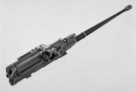

20 mm KAA Cannon
Photograph copyrighted by Rheinmetall AG
Designation Cannon:  Oerlikon 20 mm/85 KAA
Mounting:  GAM-BO1
Ship Class Used On Modern British warships
Exported to many countries
Date Of Design N/A
Date In Service about 1985
Gun Weight 203 lbs. (92 kg) without ammunition
401 lbs. (182 kg) with 200 round belt
Bore Length 55.1 in (1.400 m)
Rate Of Fire Cyclic:  900 - 1000 rounds per minute
Weight of Complete Round N/A
Projectile Types and Weights HE-I - 0.264 lbs. (0.120 kg)
Length of Complete Round:  8.0 in (20.3 cm)
Cartridge 20 x 128 mm (cartidge size is actually 128.7 mm)
Muzzle Velocity 3,440 fps (1,050 mps)
(on mount)
200 rounds
Elevation With 0.264 lbs. (0.120 kg) HE
Effective 2,200 yards (2,000 m)
Maximum 7,450 yards (6,800 m)
Aircraft 1,650 yards (1,500 m)
Designation GAM-BO1
Weight About 1,000 lbs. (454 kg)
Elevation -10 / +55 degrees
Elevation Rate Manual Elevation, only
Train Rate Manual Training, only
