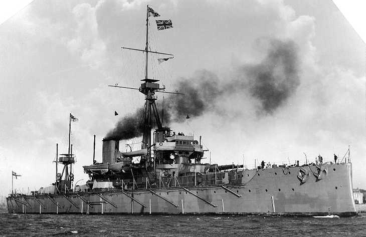

HMS Dreadnought about 1906-1907
12-pdr 18cwt QF Mark I guns may be seen atop the forward and rear turrets.  These were given light shields shortly before the start of World War I
U.S. Naval Historical Center Photograph # NH 63367

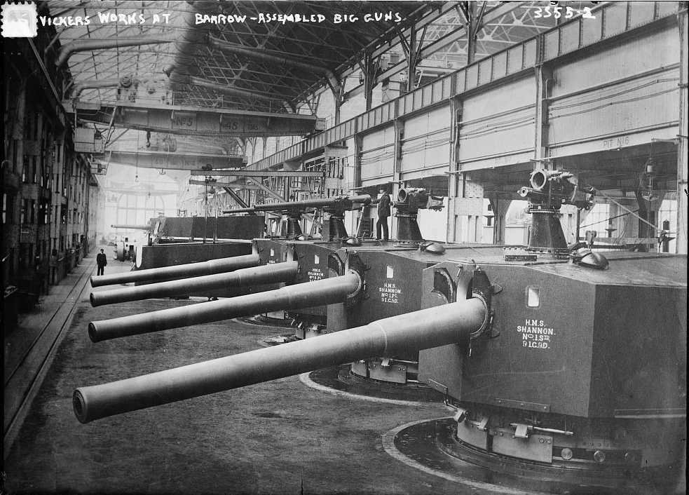

7.5" (19 cm) turrets for HMS Shannon under construction with 12-pdr 18cwt guns on top
Library of Congress Photograph LC-DIG-ggbain-19618
This image is also at The Vickers Photographic Archive as 6486
