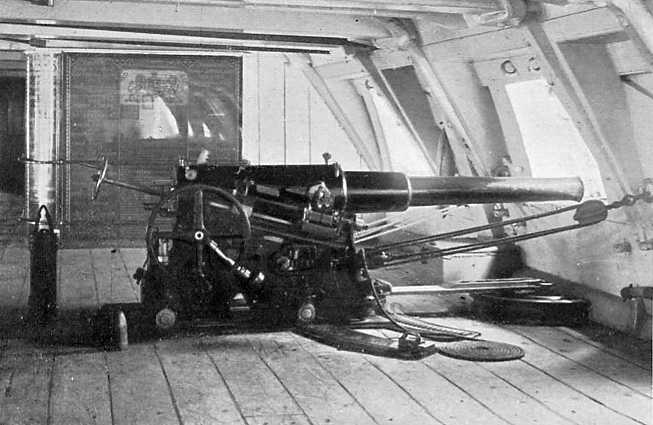

4"/25 (10.2 cm) Mark I
Not entirely certain, but this may be the 4"/25 (10.2 cm) Mark I
Photograph courtesy of Dave Perkins
Similar to the 13cwt Mark I, but was 25 calibers long and weighed 22.5cwt.  Twenty-seven guns were manufactured, of which eight guns were mounted on HMS Swiftsure.  All of them were withdrawn from service after the HMS Cordelia accident.
Mountings were VBI with an elevation range of -28 to 18.5 degrees.  Muzzle velocity was 1,790 fps (546 mps) with a 25 lbs. (11.3 kg) projectile which gave a range of 7,200 yards (6,580 m) at maximum elevation.

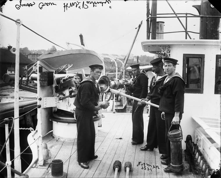

4" (10.2 cm) gun on the gunboat HMS Partridge ca. 1895
Note the 4" (10.2 cm) shells in the ready rack at lower right, the three motion breech, and the powder casing
