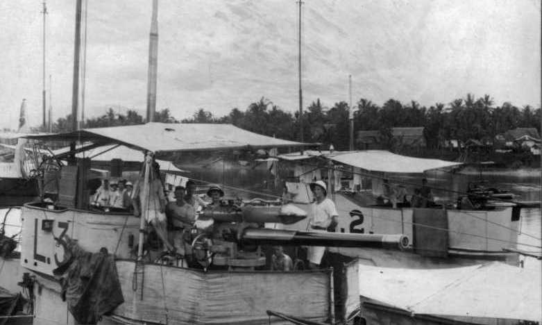

4"/40 (10.2 cm) QF Mark VII
4"/40 (10.2 cm) QF Mark VII on submarine L3 sometime during the 1920s
Submarine L2 in the background armed with a different 4" (10.2 cm) weapon
Photograph from the collection of Dave Perkins and used here by his permission
This was a Coventry Ordnance Works (COW) design of 40.45 calibers used on four Greek destroyers being built in Britain.  The destroyers were taken over at the start of World War I and accepted into service as the "Medea" class.  These ships were later rearmed and their guns then given to the submarines J5, J6, J7, L1, L3, L6, L10 and L12.  With a 31 lbs. (14.1 kg) projectile and 5.44 lbs. (2.5 kg) charge of MD16 the muzzle velocity was about 2,250 fps (686 mps).  A total of sixteen guns were built and the mountings were PXIII with a maximum of 20 degrees elevation.

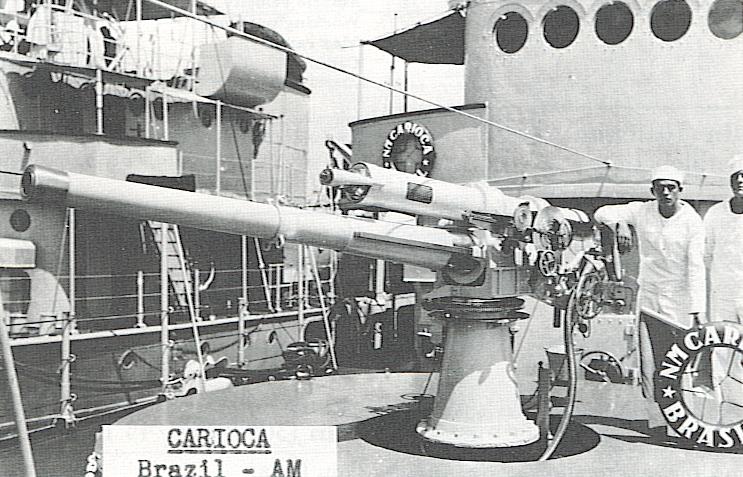

Brazil
4"/45 (10.2 cm) QF Vickers Armstrong Mark N
4"/45 (10.2 cm) Vickers Armstrong Mark N gun on Brazilian minelayer Carioca
This was a Mark N gun used to arm the Brazilian Carioca class minelayers.  Fired a 31 lbs. (14.06 kg) shell at 2,800 fps (853 mps).
