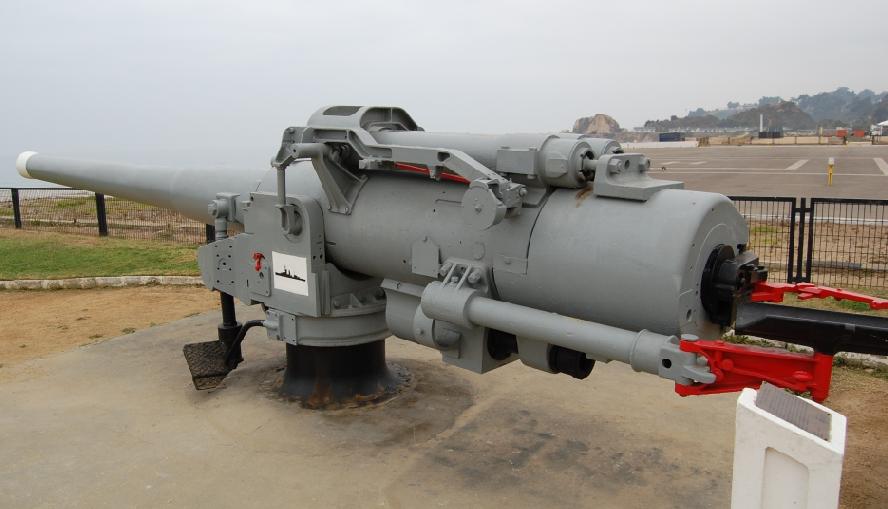

6"/50 (15.2 cm) gun from Chilean battleship Latorre now at Museo de Cañones Navales in Bahia de Valparaíso, Chile
Photograph copyrighted by Carlos Mey and used here by his kind permission
