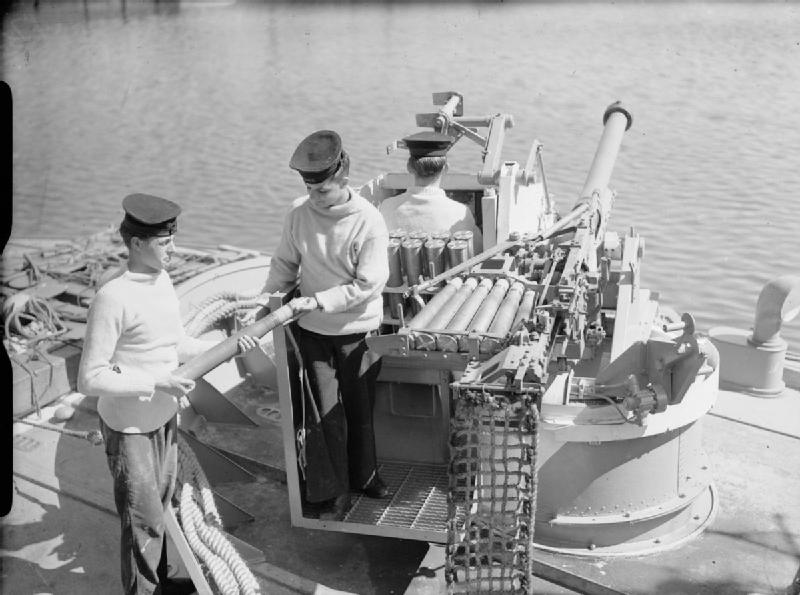

6-pdr Molins gun on HMS Mantis
IWM Photograph A 25162

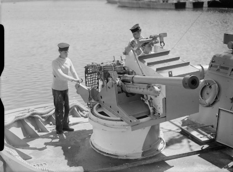

Rear view of 6-pdr gun on HMS Mantis
IWM Photograph A 25164

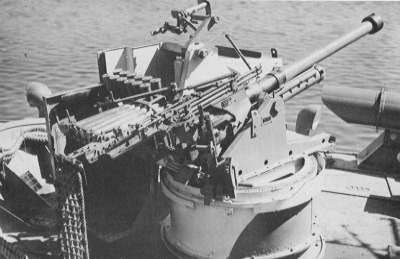

Molins gun on unidentified MTB
Picture courtesy of Tony Williams
