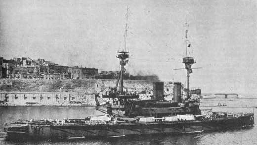

HMS Lord Nelson in 1918
The 9.2" (23.4 cm) guns are mounted in the amidships turrets

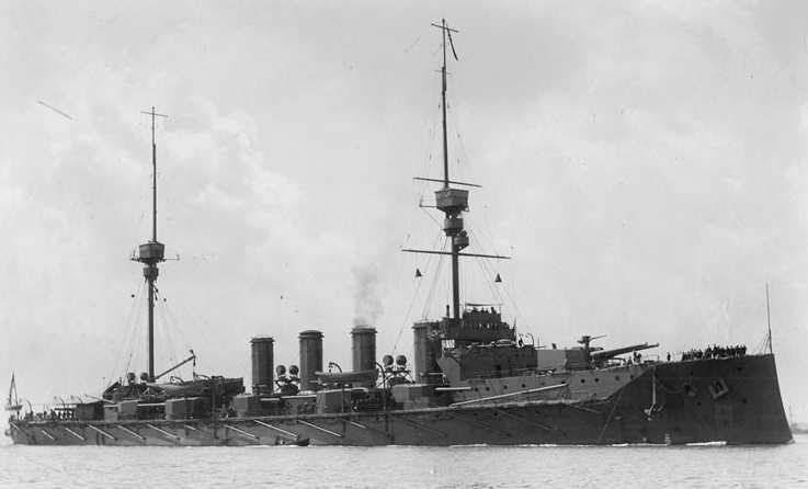

HMS Minotaur prior to World War I
U.S. Naval Historical Center Photograph # NH 66086
