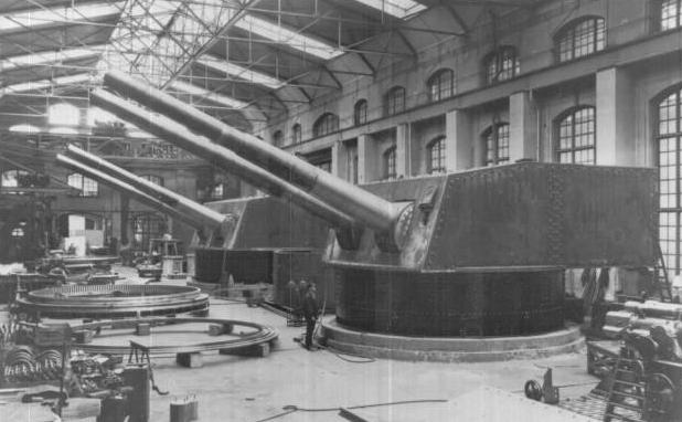

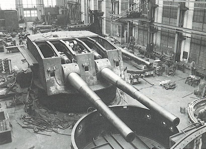

Turrets for Väinämöinen in Bofors erecting shop
Photograph copyrighted by Bofors
Turret for Väinämöinen in Bofors erecting shop

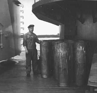

254 mm propellant casings
