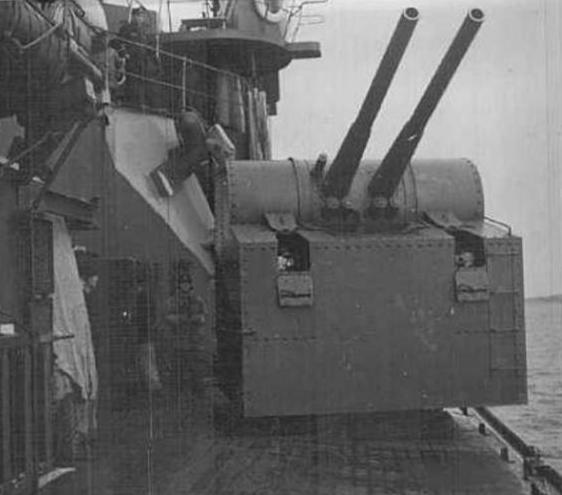

Anti-aircraft gun designed by Bofors for Coastal Defense ships.  Used a semi-automatic horizontal sliding breech block.
Actual overall length was 50 calibers.
105 mm/50 twin mounting

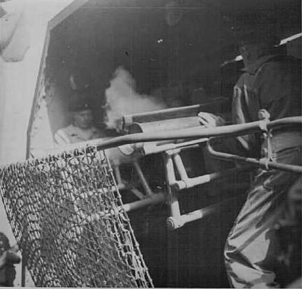

105 mm/50 in action.  Net was to slow the ejected shell casings
