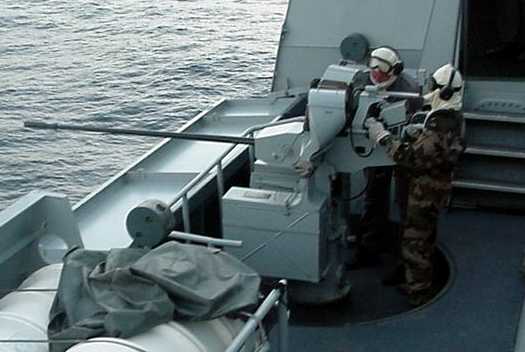

20 mm/90 M693 on Frégate La Fayette (F 710)
Marine Nationale Photograph

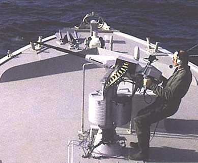

20 mm/90 M693 on Affût 15B Naval Mounting
Photograph copyrighted by GIAT and courtesy of Naval Technology

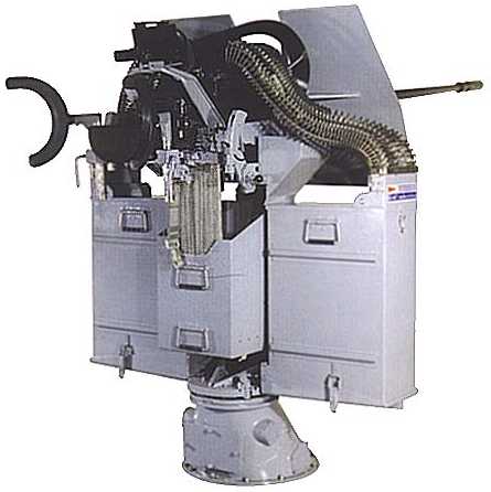

20 mm/73 GIAT M621 on Affût 15A Naval Mounting
Note the safety rail
