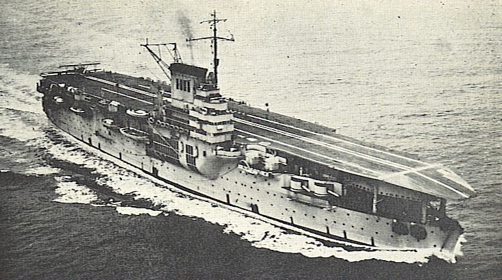

Experimental Carrier Béarn in 1937
The 75 mm (2.95") guns are in the mountings just in front of the island and below the flight deck
