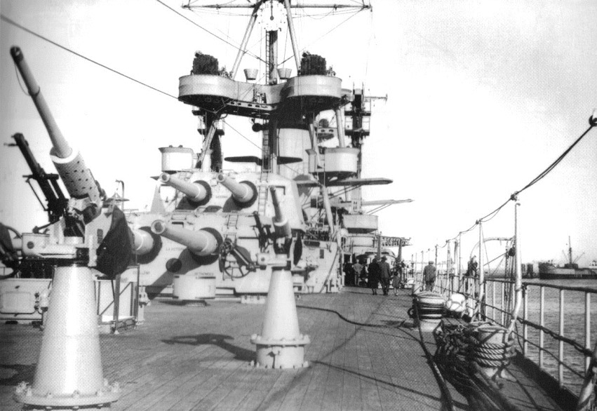

Single 37 mm/50 Model 1925 guns on the heavy cruiser Foch in 1937
Photograph from the Henri Landais Collection

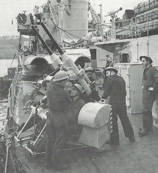

Twin 37 mm/50 Model 1933 mount on destroyer Le Triomphant in 1941
Note the ready ammunition in the "bucket" on the left of the mounting, what appears to be a ready storage locker behind the mounting, the range finder on the deck above the guns and the range clock on the bridge
CPL Photograph
