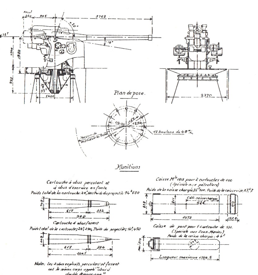

100 mm/45 Model 1925 gun in SMCA Model 1925 Mounting
Sketch in the collection of Robert Dumas
