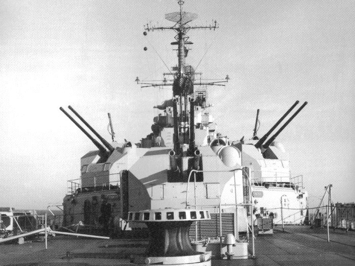

Stern guns on De Grasse in 1956
Photograph from the Henri Landais collection courtesy of Robert Dumas
