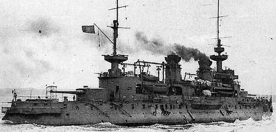

Pre-dreadnought Gaulois
The 138.6 mm (5.46") guns are along the sides

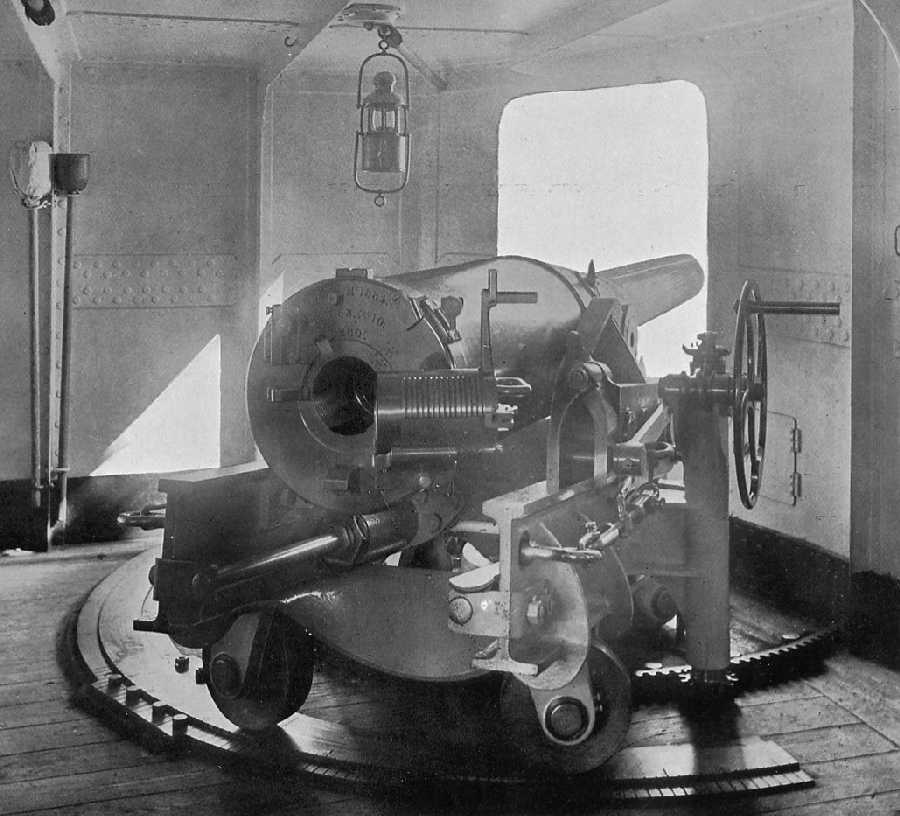

138.6 mm (5.46") Model 1884 gun modified to Model 1888
Note the four-motion screw breech
