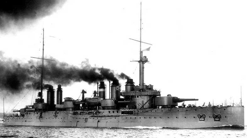

Battleship Danton
The 240 mm (9.45") guns are in the amidships mountings

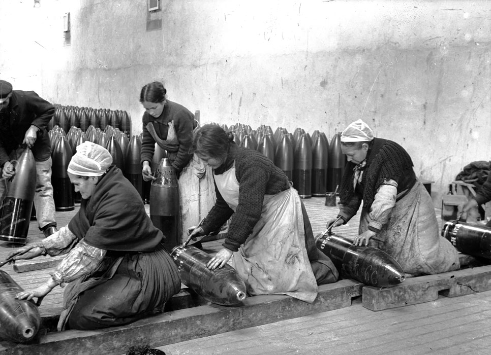

240 mm (9.45") HE shells being manufactured at Usine pyrotechnique Saint-Nicolas about 1916
Établissement de Communication et de Production Audiovisuelle de la Défense (ECPA D) Photograph SPA-5-J-409
