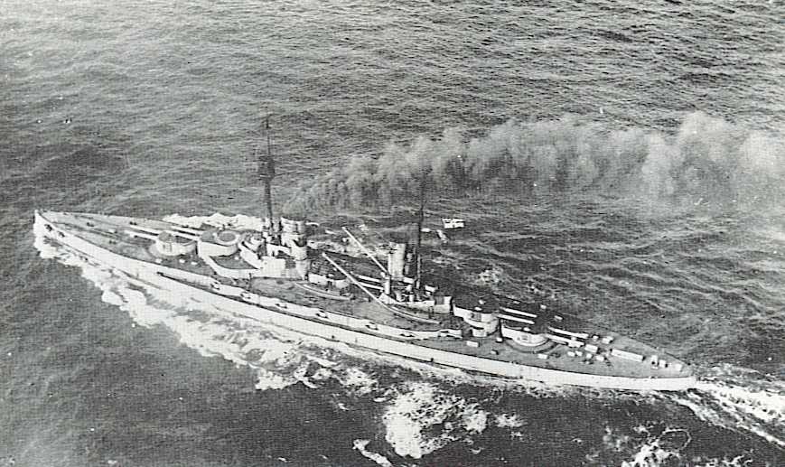

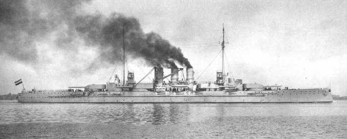

Battleship Helgoland in 1915
The last class of German battleships with a hexagonal layout and no superfiring turrets
Photograph copyrighted by HDW

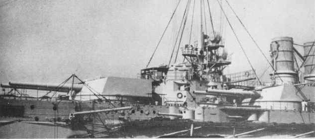

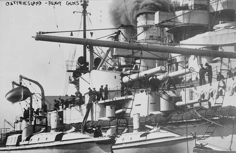

30.5 cm/50 (12") wing turret on Battleship Ostfriesland
Secondary guns are 15 cm/45
Bain News Service Photograph
Library of Congress Photograph ID LC-DIG-ggbain-17760
30.5 cm guns on SMS Thüringen

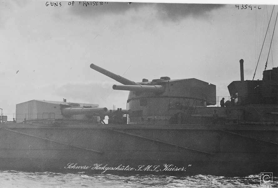

30.5 cm/50 (12") guns on Battleship Kaiser
Library of Congress Photograph ID LC-DIG-ggbain-25469

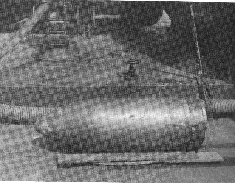

Unexploded 30.5 cm (12") APC shell that struck HMS Defender during the Jutland (Skagerrak) Battle
This was fired from the German 3rd Squadron and ricocheted off the water before hitting Defender
Note that shell has lost both ballistic cap and driving bands

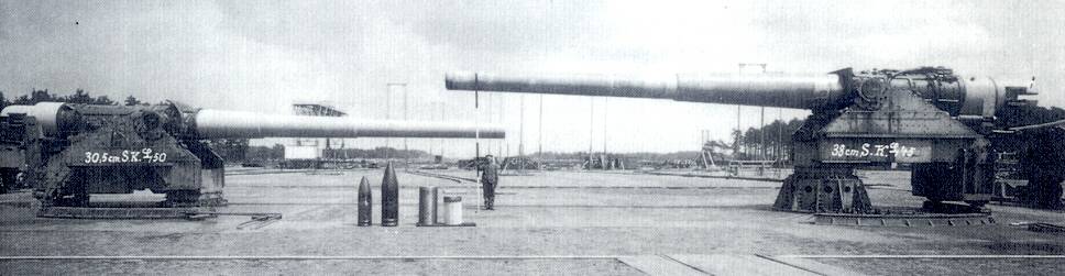

Comparison of 30.5 cm SK L/50 and 38 cm SK L/45
The propellant charges are only for the 38 cm
The sailor is holding a meter stick for comparison purposes

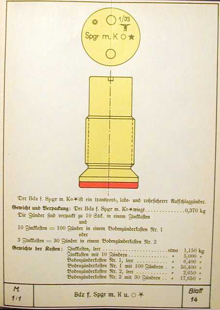

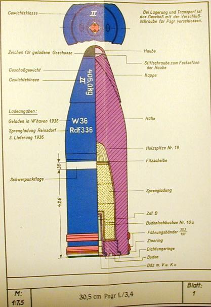

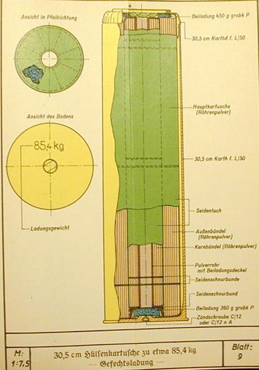

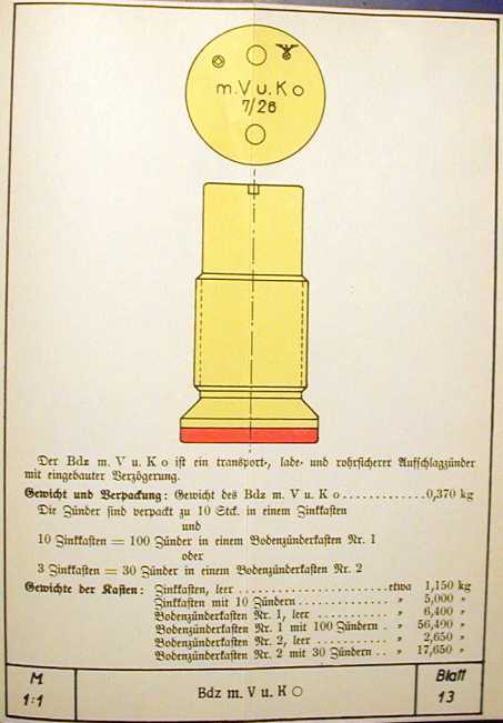

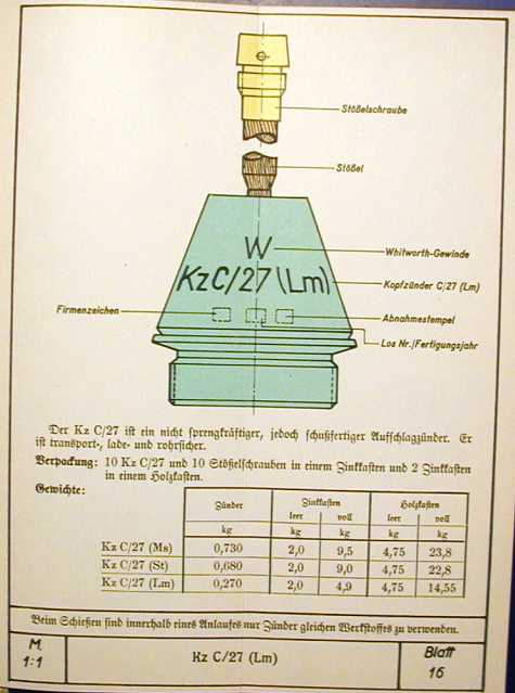

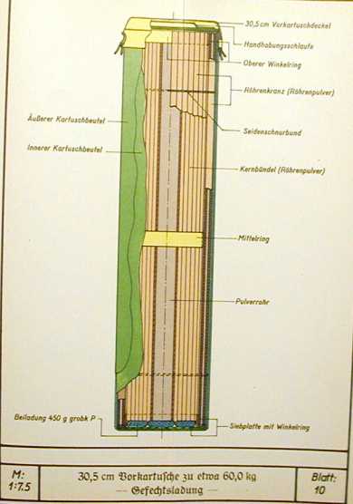

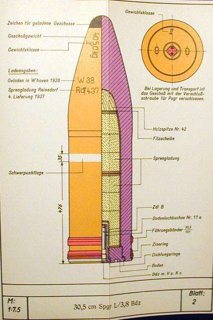

The following sketches are from this document
APC L/3,4 - Psgr. L/3,4
HE L/3,8 projectile with base fuze - Spr.gr. L/3,8 Bdz
HE L/3,6 projectile with base and nose fuzes - Spr.gr. L/3,6 Bdz u. Kz (mhb)

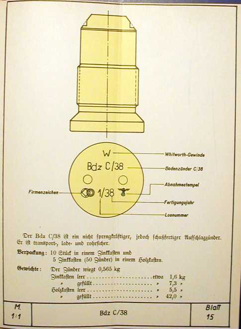

Base fuze for Psgr. L/3,4 and Spr.gr. L/3,8 Bdz
Base Fuze for Spr.gr. L/3,6 Bdz u. Kz (mhb)
Nose Fuze for Spr.gr. L/3,6 Bdz u. Kz (mhb)
Special Base Fuze
Main Charge - 30,5 cm Hauptkartusche
   Fore Charge - 30,5 cm Vorkartusche
