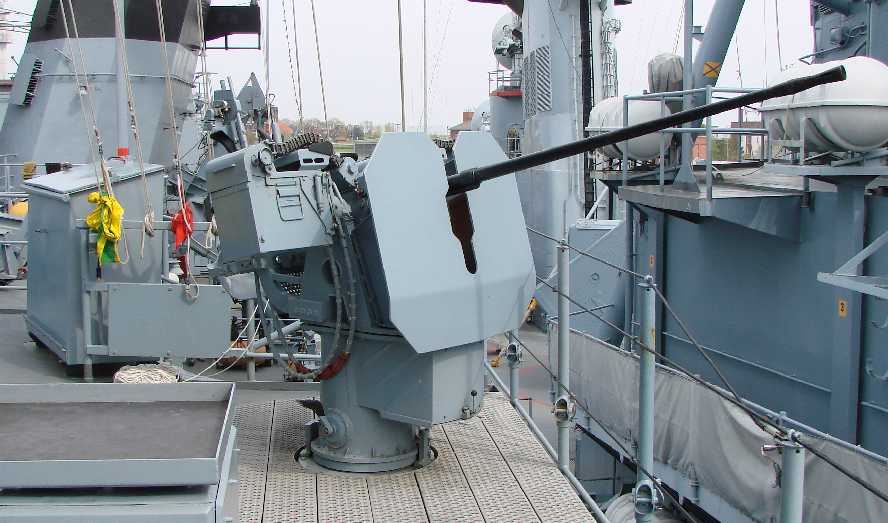

20 mm/65 Mark 20 aboard German Frigate Bayern (F 217) in April 2008
Photograph copyrighted by Markus Titsch and used here by his kind permisson

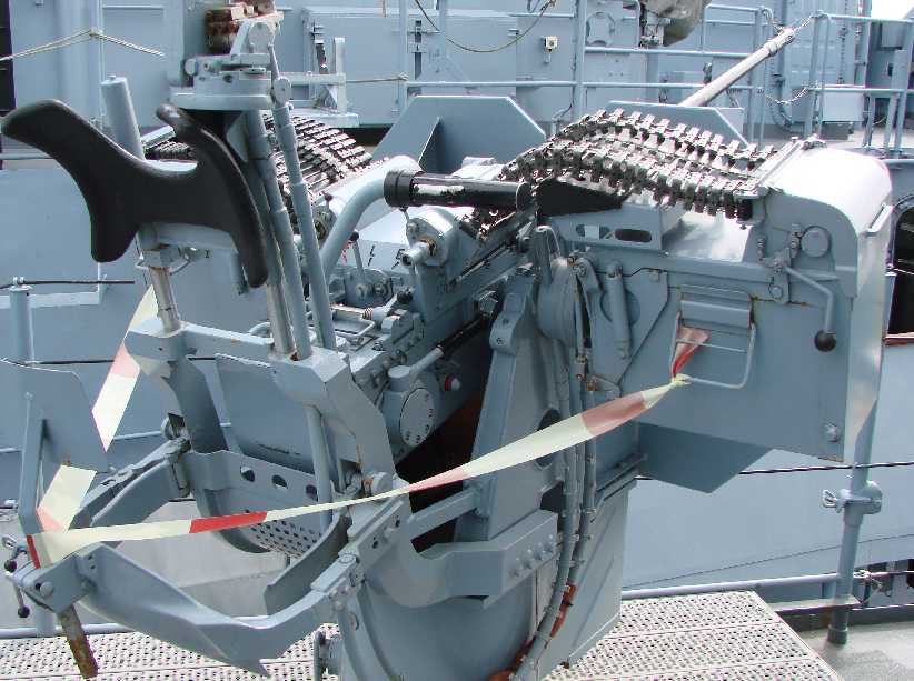

20 mm/65 Mark 20 aboard German Frigate Augsburg (F 213) in September 2004

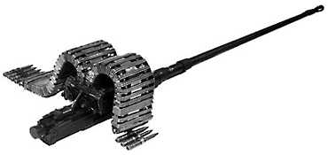

20 mm/65 Mark 20 Rh202 on Naval Mount
Picture copyrighted by Mauser Weapon Systems
